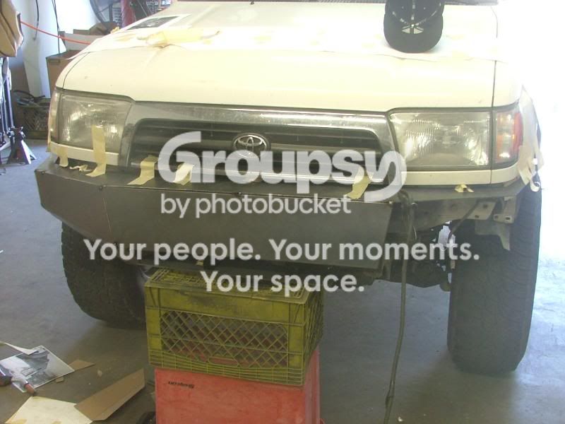

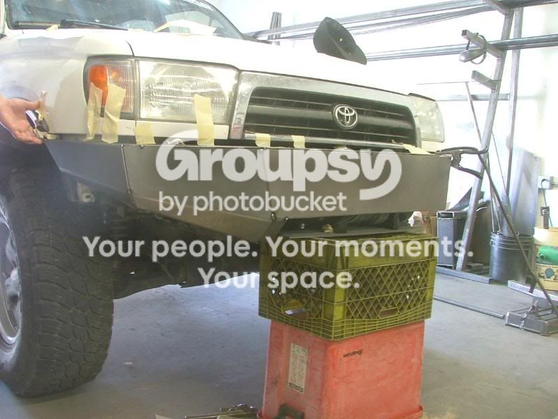

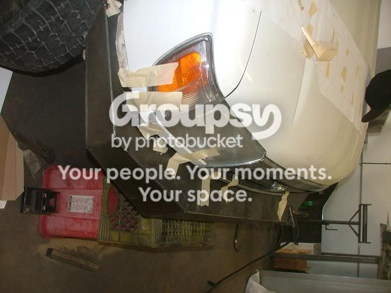

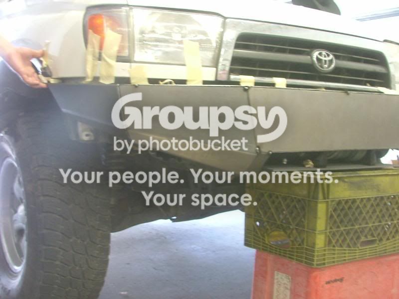

Okay so here is the status as of today. They mocked up one side and will be having CAD drawings done and then have all pieces laser cut and as much bent as possible to minimize welds. I spent just over an hour with them discussing the Winch mounting and location. It will have a 2.5" round LED for turn signal and will have a 4" light opening for fog/driving lights. The company logo is a Globe shape with long lat type lines. There is a possibility this will be laser cut in front of Driving lights if it doesnt affect the beam to much. This will set it apart a little and act as a rock guard. If it interferes obviously will be placed elsewhere. So far I am pleased with the fact they listen to my ideas and welcome my participation in the process.
DSCF5100.jpg~original
DSCF5101.jpg~original
DSCF5102.jpg~original
DSCF5103.jpg~original
Let me know thoughts input.
There will be some cut outs in the top to access Winch controls and some other things also but so far it is in the early stages. I just wanted to show some progress.
