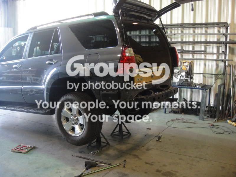

Everything removed for the install.
DSC00133.jpg~original

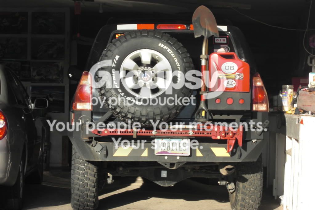

One thing you ll need to do is cut your tail pipe back just and Inch or so to clear the bumper on extreme angles it will get smooshed !! if you dont here is what mine looked like b4 I f finally cut it back ! other than that Great bumper no issues after almost 3yrs.I four wheel as hard as the 4 runner will go and the only thing I had was dropping off a ledge the bumper can hit the bottom of the tail lights / for me No biggie as my runner is a tool not a mall ride I just put a small bead of silicone in a few spots and the tail lights are fine . :guitar3::thumb3:
CIMG1851.jpg~original
