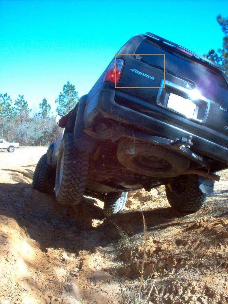

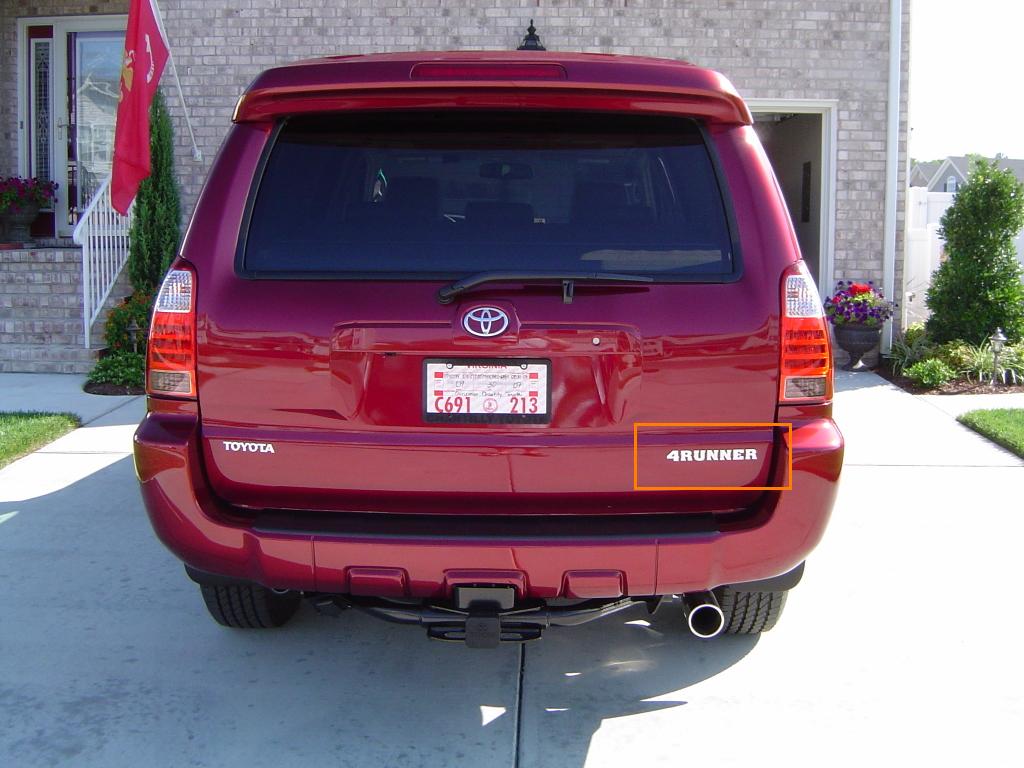

I'm pretty sure thats a 3rd generation emblem....
The first pic is of a 4th generation and the second pic is of a third generation....the only thing I can think of is that either the dealership had to use yours for another 4runner that someone was buying, and took it off then put the wrong one back on, or the factory put the wrong one on.....

SportRunner - you're absolutely right; it's a third gen badge. Good eye. Don't know how it got there but I do like the interlocking "4" and "R".

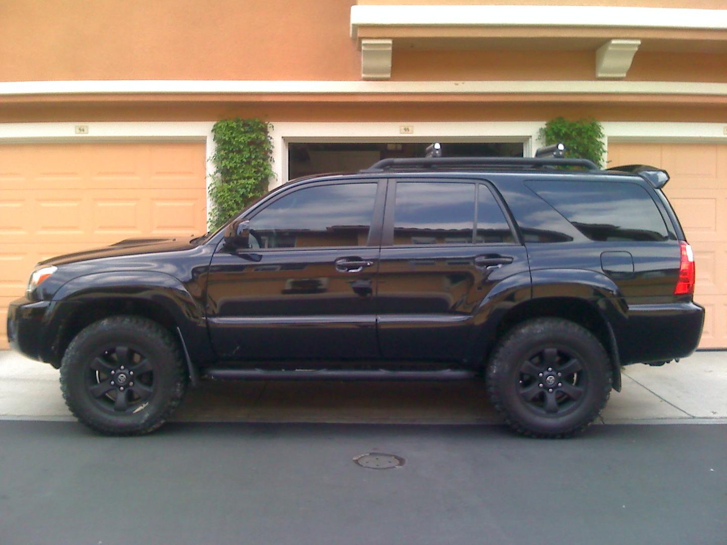

I really like the interlocking "4" and "R" as well, its a classic..... anyways I have the same lift and I love it, nice ride....I went with it so I could keep my Xreas but later down the road I want to upgrade to some SAW and upper arms so I can handle the desert better, but I'm happy with what I got right now, and u can't beat the price, I bought from wheeler's as well....

Lord Vader, your 4Runner awaits...
Lovin' those PC rims. Overall great set-up.
Thanks...they're actually spray painted with a bedliner texture paint to match my roof rack and tube steps.....I'm gonna be buying a set of limited wheels, like yours and put 32" tires on them but get a tire more for street, and use my muds for offroad only, since I don't get out as much as I'd like to....
SportRunner, What brand/model tires are you using currently? they look nice!
