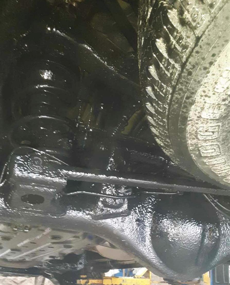

As a longtime Fluid Film user I was curious when I worked on a customer's Wrangler with a recently repaired frame with a thick, waxy, clingy, black undercoating on it. I asked him what it was and he told me New Hampshire oil. I've seen a few vehicles with it now and it seems to hold up better than Fluid Film. It is also jet black and will cover ugly looking frames. Well I just put about a gallon on my wife's 05 today and I'm impressed. Sprayed on nice, covered well. It comes in black or clear and costs about $40/gal.

If I hadn't read the post with the picture I would have thought your oil pan exploded. I'm so glad they don't salt here in VA.
id hate to be the next one to work on that
Life in rusty New England. It's a little messy, but it's not as oily as it looks. It's more for frames that are already rusty, with the paint partially or mostly gone.
