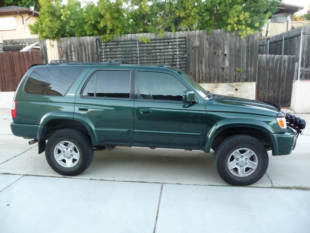

Hey, so the tundras alone didnt give me enough lift, and I definitely don't want spacers, so I here are my options. Which one would you do and why?
My front right now is at 35.85" ish
Rear is at 37.5" Thats too much of a rake for me

If I were you, I would save up for the coilovers, this way you can adjust to whatever lift height you want. I personally like the rake! I also used a small top plate spacer in the front though.....

Yeah, I probably wont do that, as I don't think I can justify putting 600 into the suspension....although it would be sweet. I also dont really need the adjustability. Either 2.5" or 3" is fine for me, and either new set-up can get me there less expensively than a coilover setup
