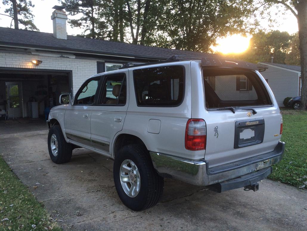

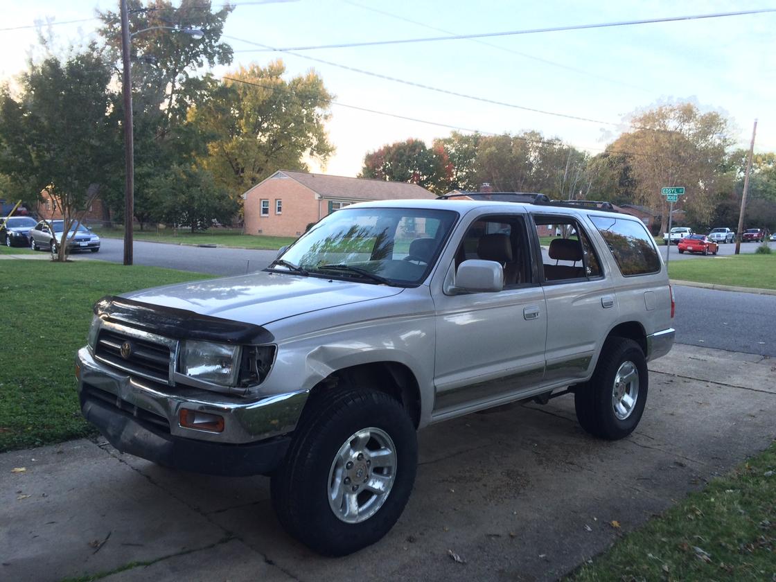

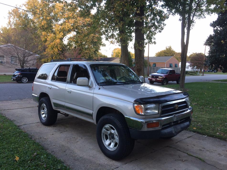

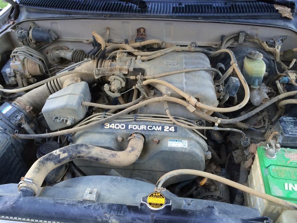

Hey all,
This is my first Toyota!

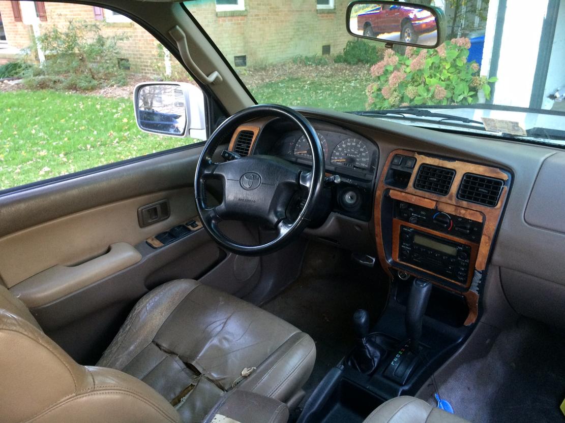

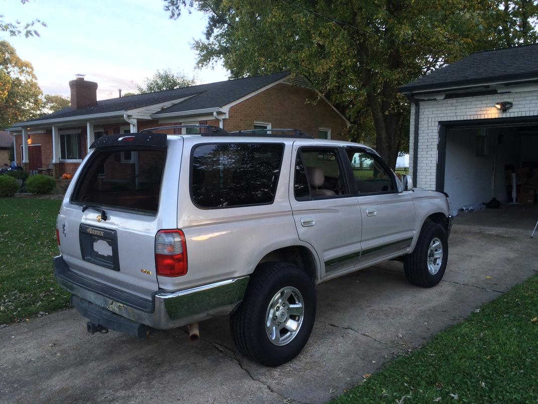

The Toyota: 1998 4Runner 3.4l Auto 4wd, Desert Dune metallic, 176k miles, no documented history, got a killer deal on it!
Issues: No documented history, dented bumper, dented fender, front driveshaft transfer case seal leak, passenger rear axle seal leak (drum brakes are bad because of this), rear shocks shaft rusted off (stock), coolant line leak for rear seat heater, surface rust everywhere (repairable enough for my current skillset), caked in mud, interior smells, steering wheel has a bend (?), previous owner cut the exhaust after the cat, dash lights do not work, missing fender flares
Good Things: Paint is in great shape, transmission shifts great, engine starts easily and runs great with no smoke, no engine/transmission leaks, all electronics work with no check engine lights. This is not my daily, so i can take my time fixing it up
About me: I have had several cars over the past 5 years, including multiple Jeeps. I have recently caught the bug of flipping cars after fixing them up, hence the several cars. Just got a new job, moved to a new town to be with my Fiance, and finally have my own garage/driveway!!! Last 2 years in a townhouse with strict HOA and 1 parking spot for a house of 4 dudes made wrenching extremely tough.
I would love to keep this 4runner, but that will be dependent on how it turns out and how much work will be needed. So far I am digging the idea of owning a 3rd gen. I am a lot closer to the beach now and would love to take it out on the sand. I like fishing and mountain bike riding, which this 4runner would be a great help with.
My daily is a 2012 Mazdaspeed3. I love it, but am scared to get it dirty. Took it to the beach last year, decided to rent a jetski on a whim with a buddy, ended up flipping the jetski and getting soaked, with no towels available and a 20 mile drive back to the house. The car hasn't smelt the same since haha.
Here are a few pictures! I am trying to document this build via video, so I am hoping to upload those as I edit them. These will be in detail with how I found the 4runner and what work I am doing to get it back to shape.
Thanks for looking!

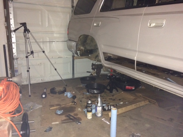

I have been busy working on the 4runner when it is warm enough outside to be enjoyable, or at least warm enough in the garage.

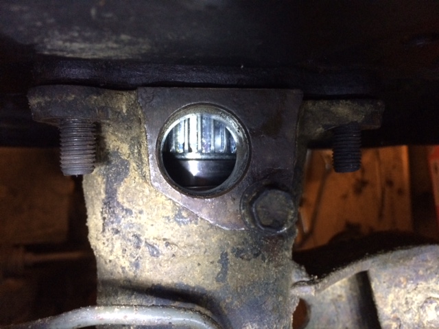

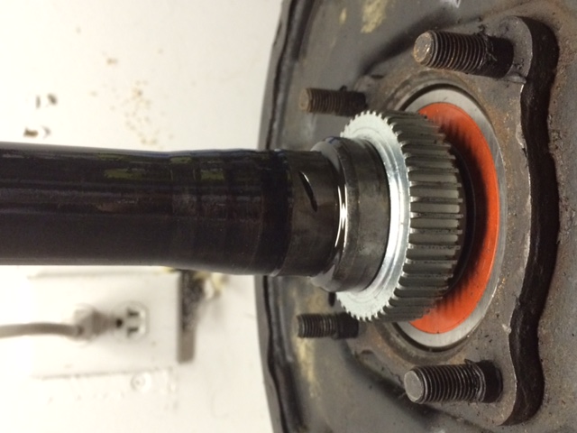

The first big project has been fixing the rear axle seal leak, which means all new brake components, new seals, new fluid, and getting the bearings/seals pressed onto the axle. It has been messy so far.
All was going well, got the axles back, only to find the shop pressed the the components on too far. The abs sensor and the coupling/race/retainer that makes the contact with the inner axle seal was too close to the backplate, creating no seal at all. I had read about this, and was sure that the shop would measure before taking the old parts off...I was wrong.
I am in the middle of editing a video on the process, so stay tuned! here are some bad iphone photos on what I was going through. My hands were covered in grease from the messy job, and after some time so was my phone
BTW: Does anyone have any tips for re-installing the rear abs sensor? It has been the most stubborn aspect of the job so far :frusty:

Here is part one of the rear axle seal leak fix. Big thanks to the thread by bigfishallday!
I went through this process with not much focus on the alignment of the bearing retainer to create the seal needed. Hopefully someone watches this video and does not have to deal with the disappointment of a poor shop install of the bearing and other machine pressed equipment.
Anyone have any tips for re-installing the abs sensor? Mine will not press back into the axle housing correctly :(
I tried to film this from the perspective of someone performing this job for the first time, which it was my first. Let me know what you think!

Thanks! The job was lengthy, but not super tough by any means. I had never replaced drum brakes either, which turned out to be fairly easy as well on the 4Runner. I'll be sure to post videos of that process and put the axle and seals back in soon.
