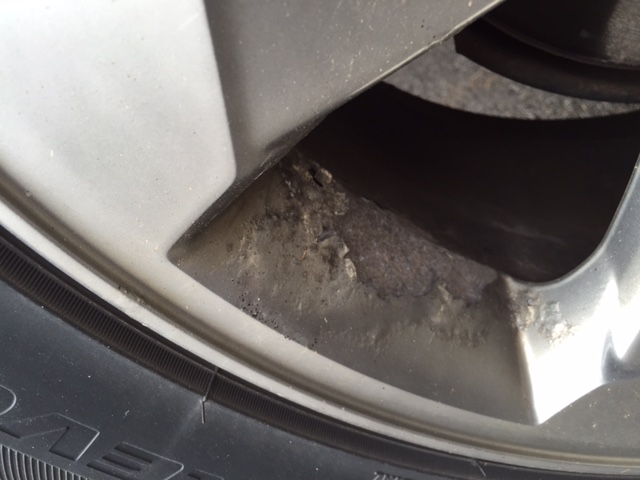

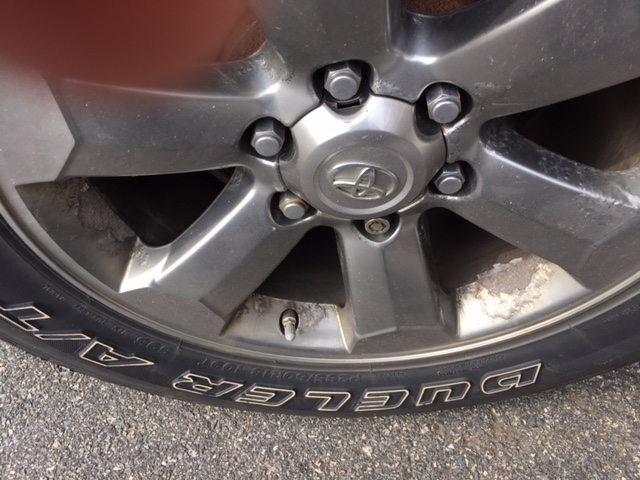

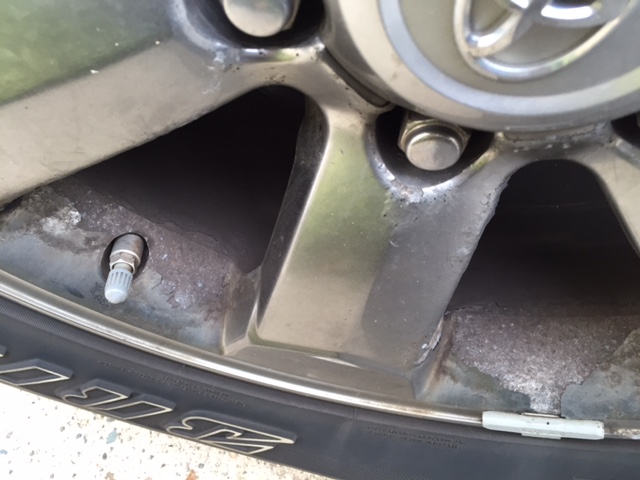

Hi Guys,
My 18" limited wheels are toast. They have been slowly bubbling and chipping and its to the point where its really getting bad. I reached out to a local (MA) wheel shop, RimPro, and was told they are too far gone to refinish. They wouldn't be able to repair the corrosion or warranty their work. So I am faced with buying a new set. I have looked at a bunch of wheels but still think the originals look great. The question is, if I buy a new set of OEM rims to replace mine, will I be fighting this corrosion issue again in a few years? Anybody else replace with aftermarket OEM wheels? Not sure if I got a bad batch or if they are all like this. Appreciate your comments.

the wheels you get are up to you... but yeah the new ones you buy will do the same thing... my wife's runner has small spots of this happening on a few of them (When we bought it two years ago (07) and I polished and waxed the crap out of them when to stem the tide, and it's really done just that) .
I would say if you go with OEM replacement wheels wax them to protect the paint real good twice a year (wheels are gonna chip and that's how the pitting starts on a painted wheel if left unprotected)... or powdercoat the wheels before installing them.... thought about sanding your existing ones down and then plastidipping them? it's another option
If my wife's ever look like yours I'm gonna take them off and get them powdercoated a gunmetal color...
good luck
Wife just got an 2006 T4R Limited where the wheels are bubbling a bit, I plan on refinishing them myself cheaper than OEM cost. :)
Thanks for the feedback. I reached out to a powder coating shop and looked into plasti dip. Interesting stuff. If I go the new OEM route, I am definitely coating them before mounting. Hopefully I can salvage the exiting ones, seems like such a waste to scrap them.
If you had them sandblasted and powder-coated a darker color, they would completely transform the look of your 4Runner. Just for reference… the shops in my area charge anywhere from $55-70 per wheel.
Give the plastidip a shot
I think with a little prep you would be really pleased with the results. I have the same wheels and dipped them anthracite gray a while back. Mine weren't as corroded, just a few spots where the clear coat was failing. I just feathered the edges in those spots, washed really well with degreaser and sprayed away once completely dry. The dip has a little texture to it and is matte so I think the corrosion would be pretty well hidden.
I've been surprised by the number of compliments I get. People can't believe it was so cheap and easy.

Thanks for sending over the pictures... the issues you're having with these are fairly common on Toyotas and we do a lot of these for the Toyota service departments.
The other vendor you spoke with was correct in saying that applying a new finish to what's there won't resolve the problem. The only way to remedy the issues with the finish would be to strip the wheels completely first. We would need the rims bare, so you could either have the tires and sensors removed and drop off the bare rims or you could simply drop off the vehicle and we could take care of that for you.
Once the rims are bare, they are chemically stripped in a non-corrosive strip tank, then blasted to remove any remaining corrosion. The wheels are then baked with a powder coated primer, cooled, and then the new finish is applied. At this point, you have the option to refinish them in the factory color, black or some other finish you may prefer. There is no additional charge for a color we already have in stock. The rims are then baked with a powder coated primer, allowed to cool and then the tires are remounted and balanced.
The overall process takes 3-4 days and runs $175-200/wheel, depending on how the wheels are provided to us and whether we would be required to dismount/mount and balance as well as remove and install the sensors. On a side note, since the process requires the tires be removed, it is a good opportunity to do tires if they are getting low and I provide my special wholesale pricing as a thank you for using us for your repair as part of the deal, if you need them. I find a lot of customers need them anyways, and the savings on the tires helps to offset the cost of the repair by usually a couple hundred dollars.

inscarguy - response from Wheel Repair Specialists below:
The corrosion is problem with the metal. Refinishing your wheels could be a waste of money. We have tried refinishing this type wheel several times with no success the corrosion returns.
Maybe you should consider purchasing new wheels.
