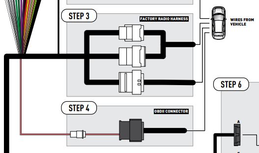

TPMS runs off the SIL wiree at the OBD2. Make sure that is hooked up, no other dongle there and wait a little bit.

SIL is the data wire at the OBD2. The Maestro should have a connector that plugs into the OBD2
Step 4
