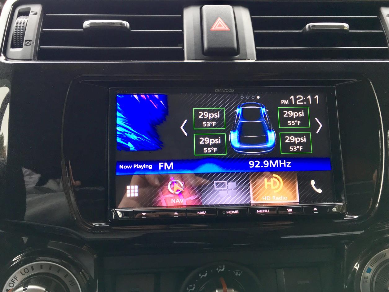

Kenwood Excelon DNX994S installed.
Ok, I had it installed in my 2017 Off-Road.
The installed cost was only $175.00 above all the stuff from Crutchfield. Money well spent!
The only hitch was the adapter for the shark fin satellite antenna. Apparently the connector on it’s cable has changed for 2017. It’s not the square one in previous posts. So we’re sorting that out. But I discovered it’s an SMB connector in a new weird connector housing.
This Nav/Multimedia unit is awesome!!!

After having this a week I wish i had gotten another brand.
1. Has obnoxious screen glare. The screen is pretty but very reflective. Even on a bright overcast day, I took a turn and the screen washed out. The screen tilt and backlight adjustments are nifty but you shouldn’t have to play with them just to see the screen.
2. Confirmed with Kenwood that the built in navigation does NOT have any voice control of any navigation features. So to find destinations on-the-fly you have to type on screen.
Hello Kenwood? It’s 2017!!!
3. Does not play any text messages unless you connect via USB (I’m iPhone 6S and don’t know about Android). This feature doesn’t work connected by Bluetooth like my rather lame OEM non-nav unit.
It’d also be nice to create a route on another device then sent it to this unit. It is Garmin, and my Garmin stand-alone has an app to do just that.
So, only a week into ownership and I have huge buyers remorse.
