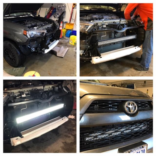

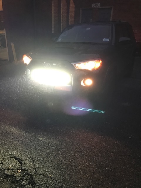

I put in the 32" light bar from Cali Raised LED and the mounts they offer on the site. They have a youtube video for the install, and Rago Fabrication has a video as well. The install itself was pretty straightforward and more or less easy. I had a friend help remove the the front bumper, although it's not necessary.
The one issue we ran into was reattaching the bumper. The mounts stuck out just a little and were hitting the grill, preventing us from attaching the bottom of the bumper. We marked on the inside of the grill the contact points, removed the bumper again, and filed the spots down with a Dremel. It was a real quick fix and isn't noticeable.

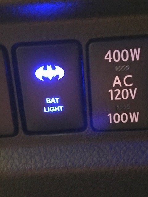

The light also came with a wiring harness and rocker switch, but I bought a switch from Air On Board. It fits perfectly in one of the empty slots and looks awesome. The light itself is great and is incredibly bright. I use it really early in the morning in NoVa so I can see deer on the roads, among other things
