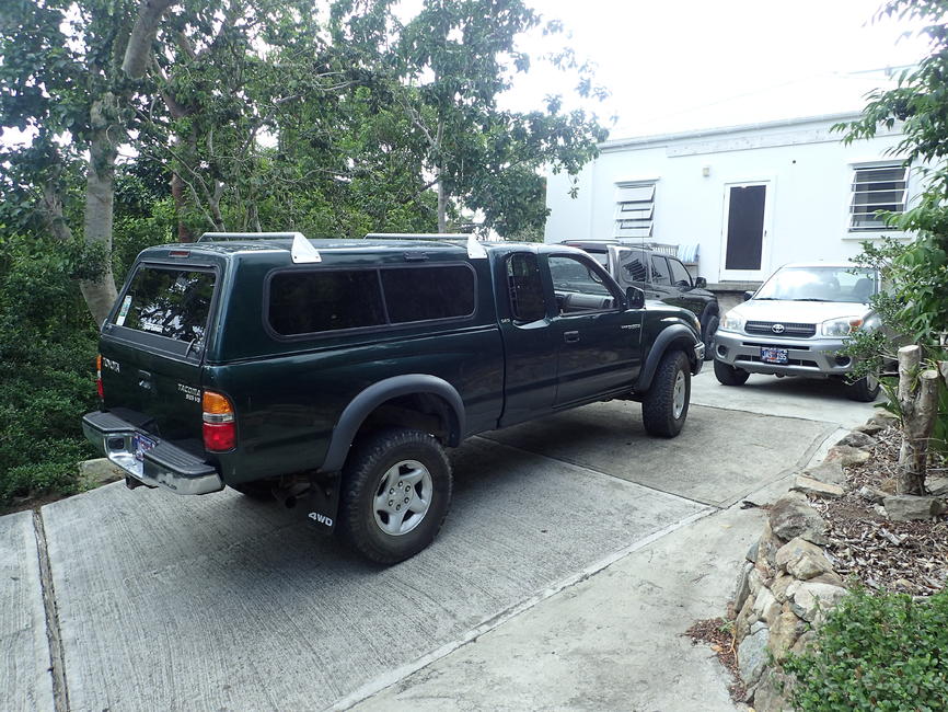

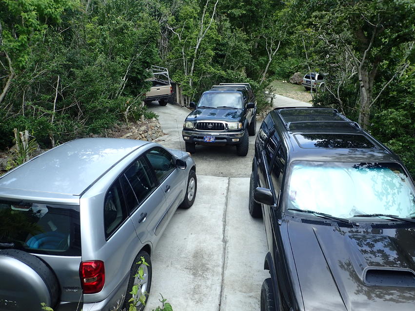

I bought another Tacoma and am selling my old tacoma. Its a 02 3.4 5 speed extra cab with a rear locker. 135k miles. Swapped everything i wanted off of my 99 single cab and am going through the maintenance. The problem I have is the high idle of 1200 rpm. I know its a tacoma and not a 4runner but I thought I would ask here first before I signed up for a tacoma site and got my a** handed to me. Starts up a around 900 rpm when cold and increases in speed until she is fully warm at 1200. Rock steady at that idle as long as she is warm. I removed the throttle body and cleaned it as well as the IAC and reset the ecu by disconnecting the battery. All is good and tight with the cables and throttle plate. I am thinking the IAC is bad and I have also read that there is a temperature sensor too. No codes and runs perfectly. Any suggestions for me? I have never had an idle problem with any of my other toyotas so I don't have a lot of experience with this one. Some pics of the family too P9130714.jpg
