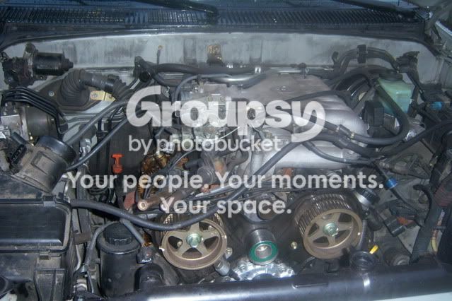

Bought this basket case 99 4Runner Limited off Craigslist back in Feb and just finished her up this month. Previous and only owner put 200k on it before a blown HG put it out of commission. I decided to swap a 2wd JDM import and make myself a new DD.
What it looked like when i bought it.

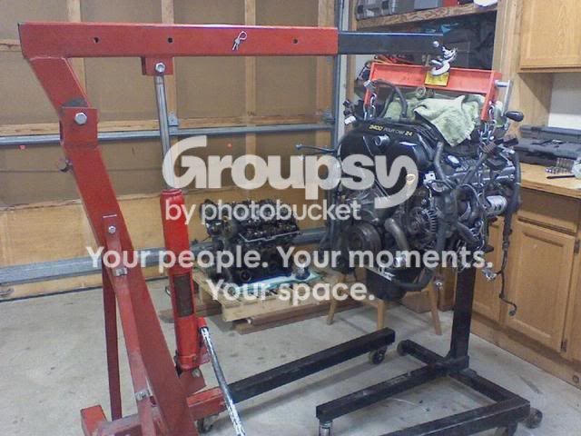

New motor after everything, and i mean everything, was swapped onto the import block.

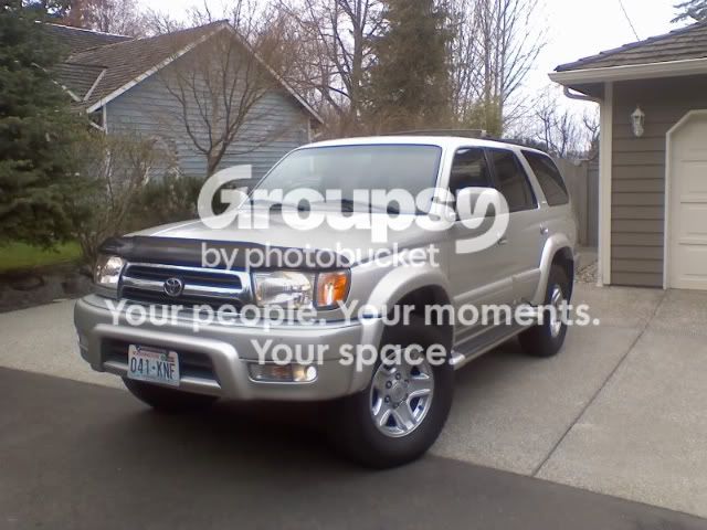

And here she sits today
