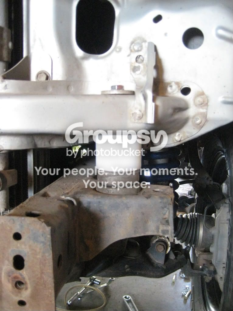

I have had a 2.5" Febtech suspension lift for about a year and a half. A few months ago i went to put on some 285's and they were rubbing... So i ordered a 1.5" 4crawler body lift. Once i installed it I got rid of the 265's and went with 285/70/17 BFG Mud Terrains. And the last thing is a Blue LED dome light from oznium.com suggested by Fo_Sheezy!
Take a look at the pics and let me know what you think!
Installing the Body Lift...

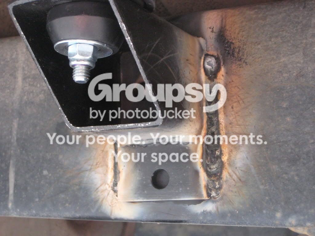

A little welding...
IMG_0834.jpg~original
IMG_0847.jpg~original

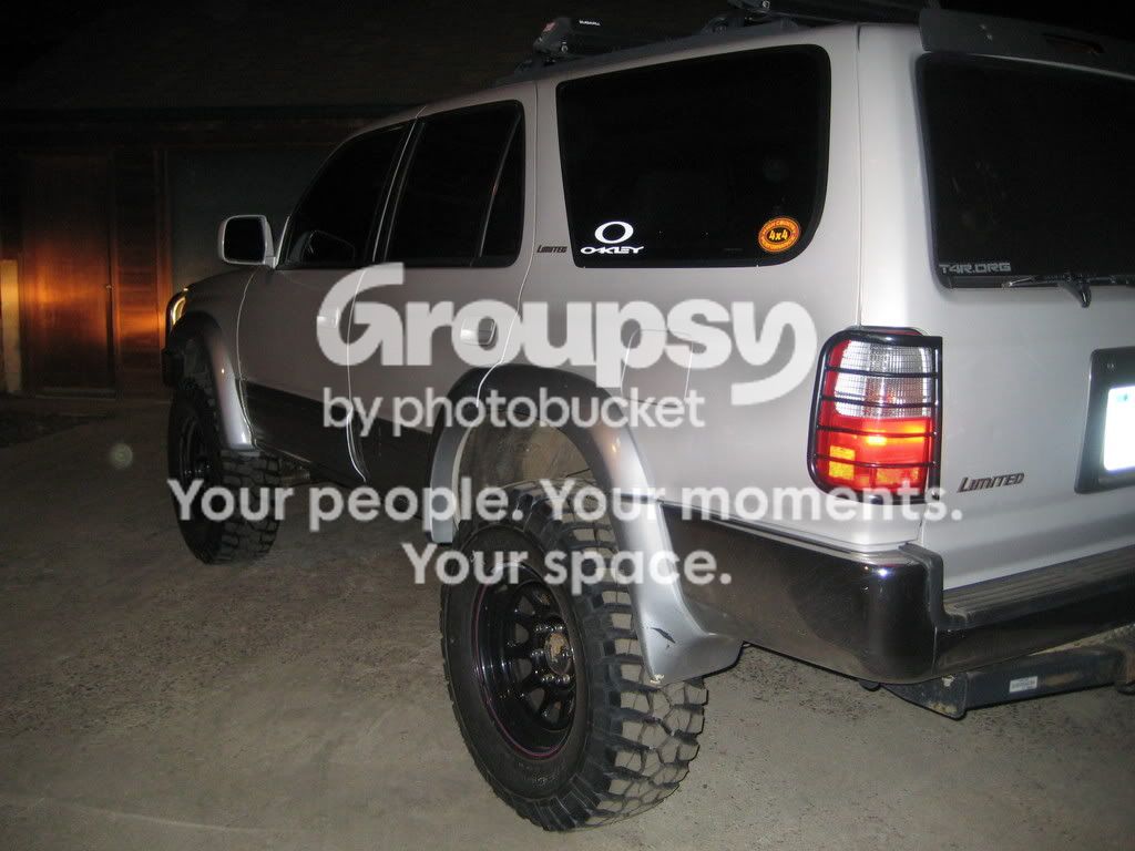

285's
IMG_1064.jpg~original
IMG_1066.jpg~original
More lift + New tires =
IMG_1070.jpg~original
IMG_1071.jpg~original
IMG_1077.jpg~original
IMG_1075.jpg~original

Sensational! You've got a great looking ride there. But what was the relocation of the bracket for?

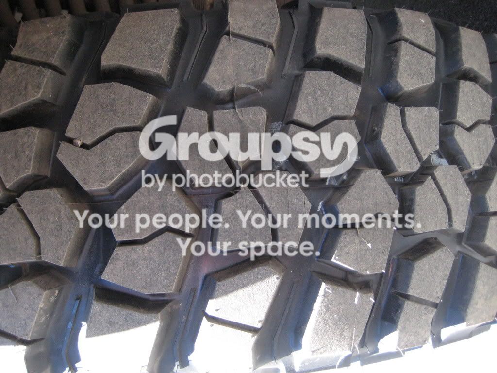

I didnt know BFG had a new mt tread pattern.

The 96's only have 8 body mounts where as the 97 and up have 10. Its really strange. So the kit comes with 2 body mount brackets which can bolt on or be welded on. I had my dad weld them on.
Im not sure how new this tread pattern is... but i've never seen it before. Im not sure if i like this one or the older tread pattern more.

Nice looking rig! How are the new BFG's working for you?
Haven't gotten the chance to take them on any trails yet... and im thinking i'll stay away from the trails this weekend, being 4th of july and all. But so far I really like them. Heard they were loud on the highway but its not bad at all.

The BFG KM2 came out around October last year. And I think a 285 is the smallest they go for now. They are in production in smaller sizes that should be trickling out this summer, I believe. It's a bad ass tire! :cool:
