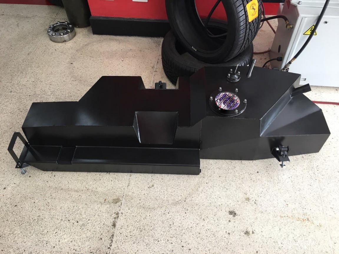

My new larger fuel tank 130-135 lts. (was 76 lts OEM) Stainless steel. 40kgs weight. Made locally for 4th gen 4R. No mods requiere. Same pump, hoses. no removal of spare tire. Cannot use original tank metal protection. 2h install. 1500$US. 24h since install sofar no issues. Very useful in a communist country (Venezuela) where you cannot find fuel outside the capital city.

A couple of questions....you mentioned "130-135 lbs" and "40kgs", which is the actual weight of the new tank?
Also you didn't mention how much gas the new tank holds?
I think that's a reference to capacity.
76 liters = ~20 gallons
135 liters = ~35 gallons
Thanks, that makes more sense, my old eyes saw "lbs" and now I see it's "lts", which isn't the abbreviation for litre, which should just be "L", so between that and my old eyes it threw me off what he was saying.
Sorry wrong abbreviation. Yes is liters.and yes the weight of the empty tanks is 40 kgs. Just today did a couple of hours highway trip and no issues.

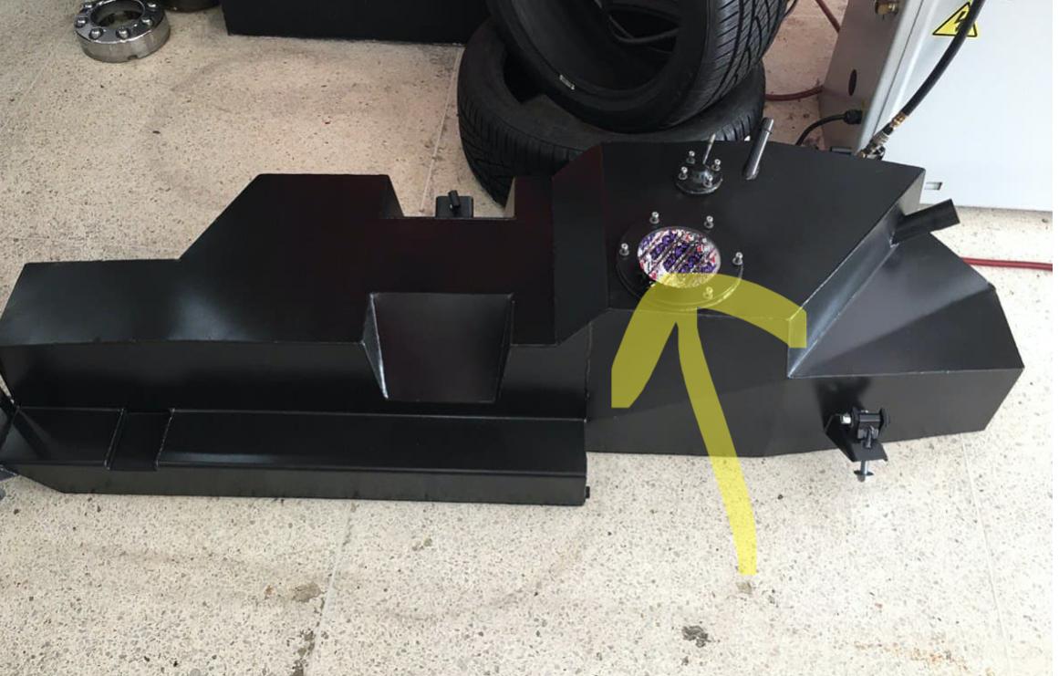

Isn’t the fuel filter located in the OEM tank? Of course an external ff could be rigged and might be better since it can be changed.
Same fuel pump and filter go in the new tank (hole with the yellow arrow). No external fuel filter.

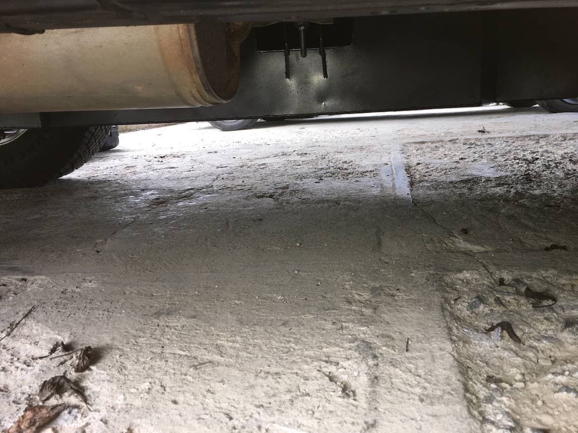

This is cool. Do you have a side picture of how low that tank hangs? Is the bottom of the tank thick to protect it off-road?
Will get side pic next day. Hangs 1 o 2 inch lower than OEM. Don't know how thick is SS bottom, feels solid, will ask seller. Lower front is slanted.
