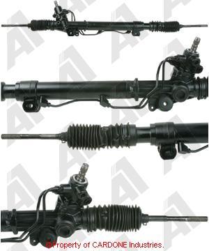

I did not have a chance to see it from underneath while on the lift at the mechanics, but I have crawled under and do not see anything out of the ordinary, except for the steering tie rod ends (the last piece - with a female thread - that screws on the rod coming from the rack and pinion assembly - see a picture of the latter in the attachment)... The one on the driver's side is perfectly horizontal. That is, the perpendicular prone end (about 1 inch or so in length) points perfectly upwards, just like in the pic shown in the attachment. The one on the passenger side, on the other hand, is rotated about, I would say, 45 degrees (!). Is this normal? Why is it not positioned in perfect symmetry with the one on the other side? :wtf: Also, as a side note (and this is perhaps just my visual paranoia) the tie rod kind of looks not perfectly straight...

Is there any evidence of an accident or damage? Clean CarFax? Are the tires worn at all unusually? This could be an alignment issue, and your observations might be important clues. Take it to a frame and alignment shop, preferrably one with a frame machine where they can take measurements of your frame using a precision frame machine. Although it sounds like any alignment shop may be able to verify your alignment.
