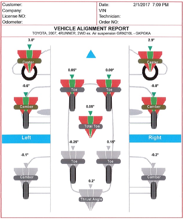

I had new tires put on, Sumitomo Tour LTX 265/65R17. After installing the tech told me my alignment specs were good and I didn't need an alignment. From looking at the forums it appears I'm within spec but I'm having an issue.
I drove a 650 mile road trip this weekend and the 4Runner was very twitchy on the highway at speeds above 70 mph. It was almost like white knuckle driving as the slightest gust of wind or imperfection in the road would make it float/drift.
My caster looks good, so I'm wondering if the poor highway handling could be a function or worn out xreas? If so I'm going to have to rip that out sooner then expected as it was really sketchy to drive at highway speeds.
Attached is the align report, let me know what you think.

It would not be surprising for the xreas to be going/gone after 10 years. No time like the present for a suspension upgrade

I've noticed the same exact issue with my 06 2wd. Anytime I'm on a highway, it almost feels like I'm trying to drive through slick sand at 70mph+. Any little bump or gust of wind will make it drift.
I'm assuming you have xreas?
My research on the forums seems to indicate this is a typical symptom of worn out xreas. In addition to the twitchy highway handling I also experience a see sawing motion sometimes when rolling down the road.
Another forum member suggested airing down the front tires to 4 Psi less than the rear tires to improve the twitching highway handling. I haven't had the opportunity to try this yet but I will before my next road trip in a few weeks and will report back the results.
In the meantime I'm saving up for a decent suspension replacement kit. I was set on blisten 5100 and FJ springs as cost is important to me, however I think I'm going to save up for a little while longer and go with the slee lowlift kit that includes:

Edit: For anyone searching in the future, I solved the handling issue. After the new tires were installed the tech aired them up to 40 psi! Dropped them down to 32psi as recommended by the owners manual and the handling has greatly improved
