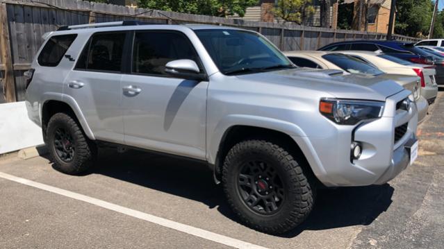

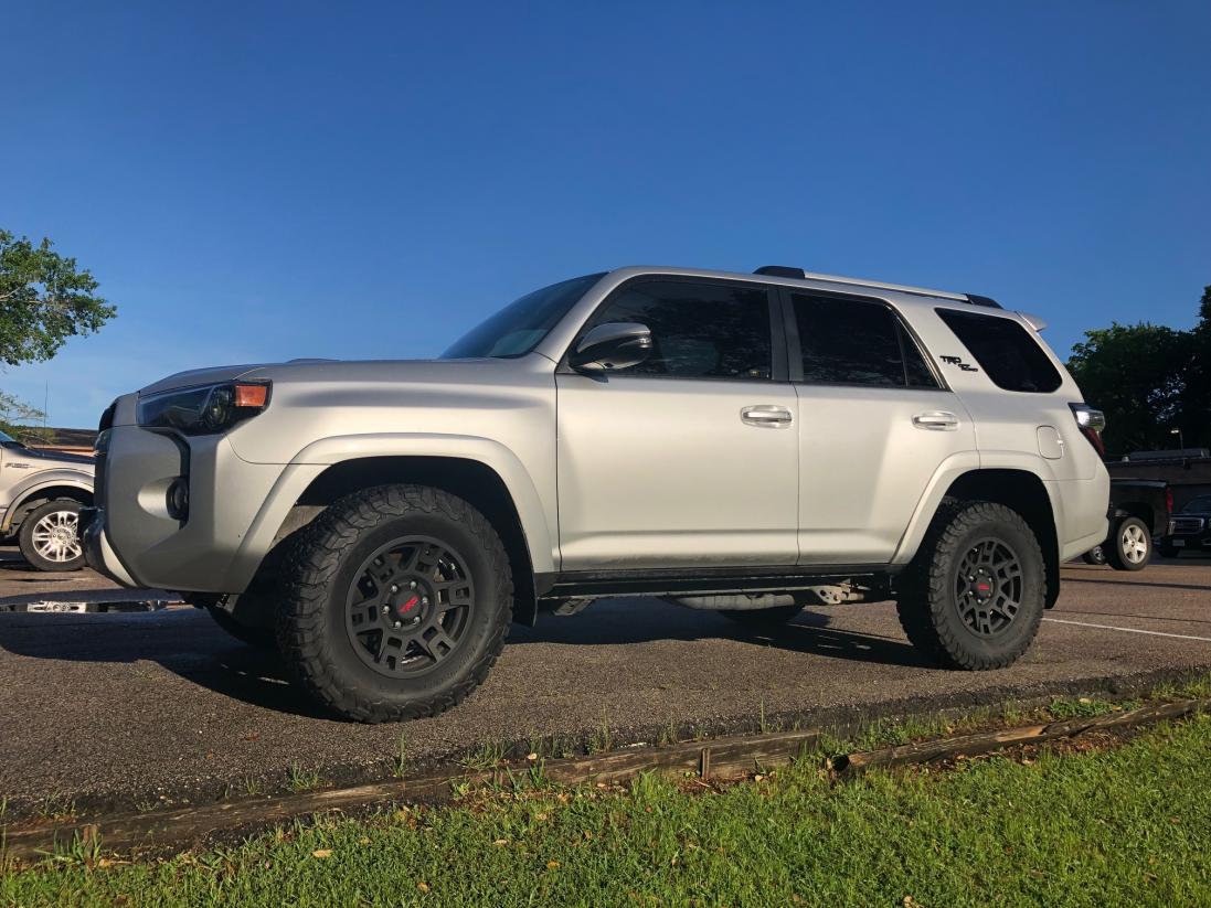

The biggest difference, by far, is the sound. The KO2s are IMO at least 50% quieter than my previous Duratracs. The Duratracs looked better but the KOs were not as loud and hummy. The pictures show the difference in looks, I wish they showed the difference in sound.
As far as how they ride I didn't see too much of a difference.
