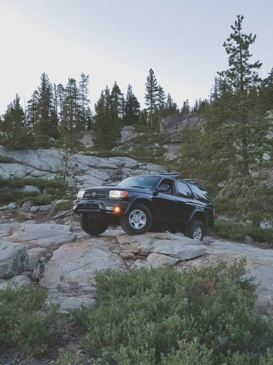

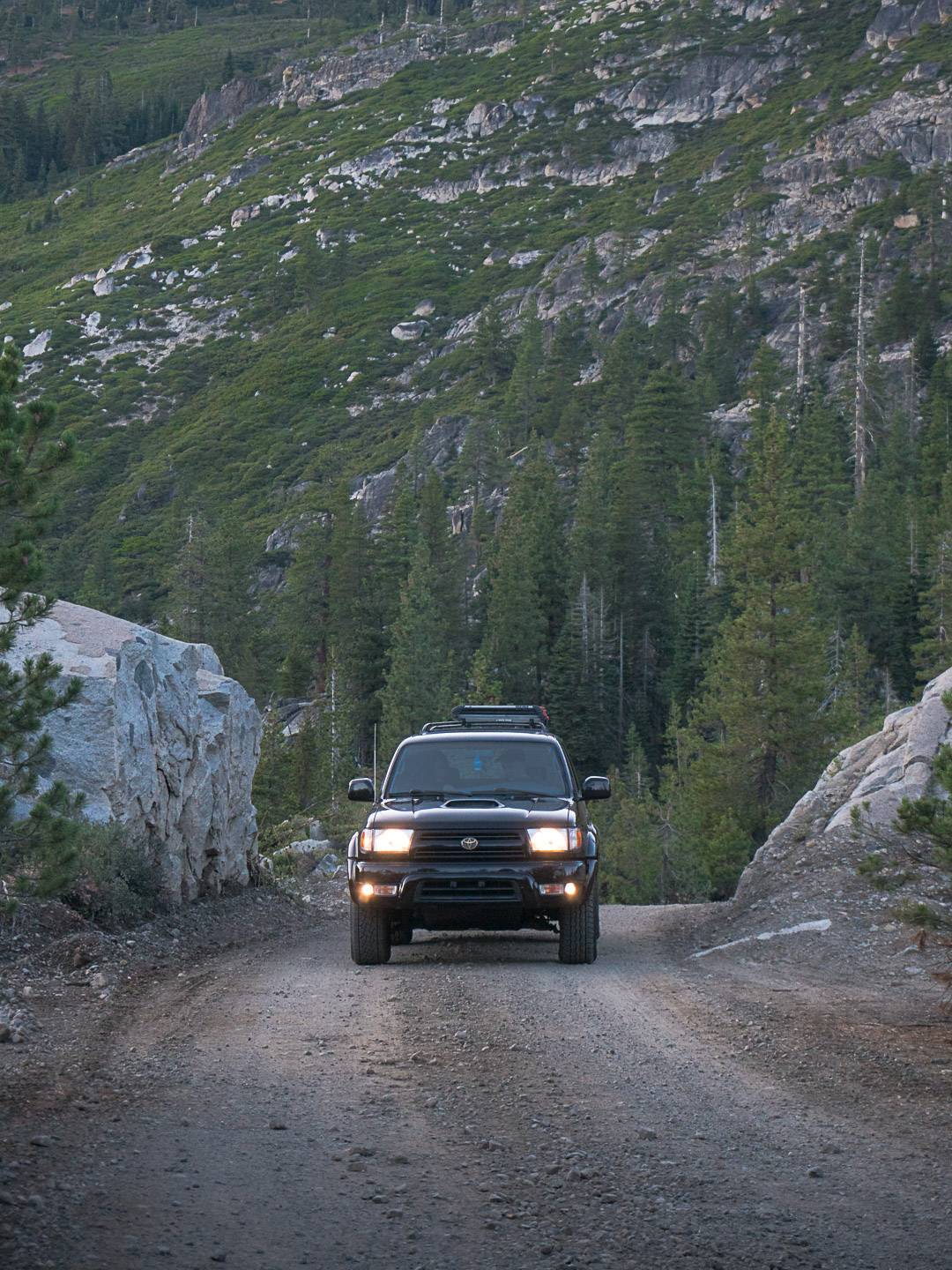

Hey guys so I'll add some background about my truck. But I was wondering if I should replace my radiator, it has 163k miles and the previous owner was not sure about the radiator being replaced. At what mileage is a new radiator needed? Anyone have any suggestions on companies or stores?
I purchased this vehicle almost two weeks ago, I've been driving it daily to school and other places in northern California. This past weekend i tested the 4x4 for the first time, and I absolutely cannot wait to get out there and explore some more. Here's a few photos, I also uploaded a video to my YouTube page
