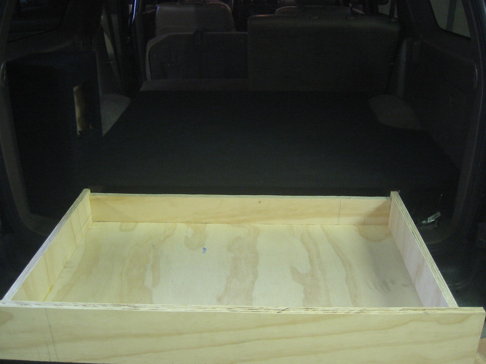

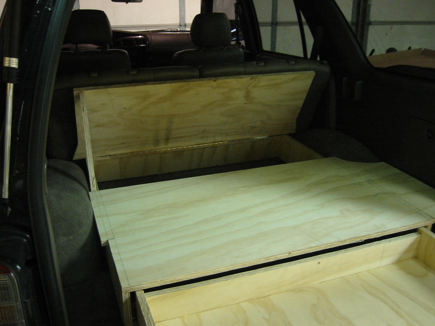

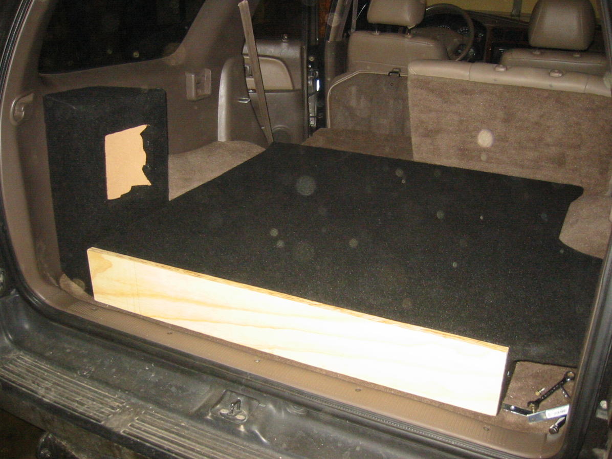

I finally got around to building my rear drawer system for my 98 runner.
I made it short enough so that I can still use the factory side compartment and 12 volt outlet on the side. It has a 22" deep by 36" wide drawer. The forward cubby compartment which will house the two amps is 15" by 36". The overall height of the deck is 6".
I made the sub box on the side to fit a kicker Square solobaric 8.
I haven't finished the drawer yet im waiting on a lockable paddle latch.
I was going to go with tan carpet too but it was backordered for a month. I think the black will be good anyway. It will hide stains better.
Overall I'm happy with the outcome. I only have $65 into it also.
