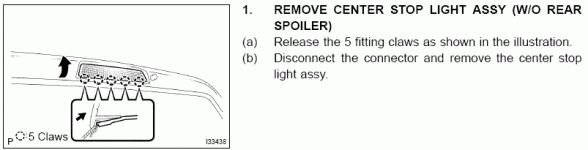

the tech stated that he had to tap into the factory third brake light wiring that was in the rear door. He stated that he couldnt diconnect the original third brake wiring because it would upset the computer and it would start to trip various codes and it wasnt worth the troubles. So when I brake both lights come on. How do i take the bulb out of the original light housing? I dont see any screws to remove the lense housing.. in order to take out the bulb.

This should help with the factory stop lamp.

Thanks for the diagram. That explains everything, but the only problem is that I will probably have to remove the spoiler in order to fully get to the original light housing. I can reach it, but I dont know if the light assemply is too thick to get out from underneath the spoiler spacing. :cursin:
