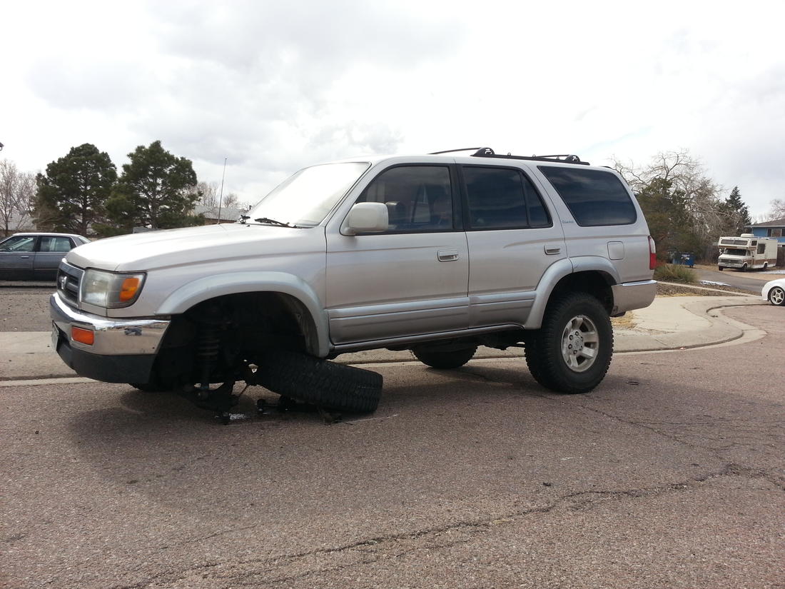

I dont see how that front spacer does not preload the suspension. It fits above the top hat im guessing instead between the coil and top hat. I was like you guys, thinking I should go cheap. This is what happened to me when I decided to go cheap.

This goes to show you how bad these spacers are on ball joints. I'm not worried about mine. They only have 11k on them. You should be fine if you have recently replaced them, if not, and you plan on keeping your originals till they start to fail, DO NOT GET A STRUT SPACER! Haha. Coil spacers (the ones that actually go on the coil inside the strut assembly) should be alright. They may cause premature sag though. Especially in the rear.
