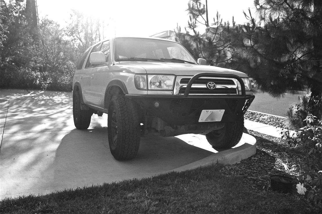

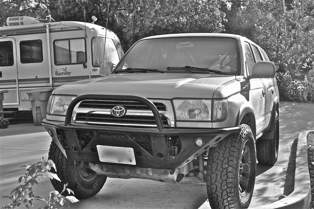

Got the bumper mounted up today, Im stoked with how it turned out. quick question, does anyone know how to wire the turn signals that came with the bumper? (round orange ones on the bumper) I cant seem to get it right. They are incandescent, not LED, so I was under the impression that they should wire right up but I can't seem to figure it out.

Looks killer! Can't wait for mine to get here, hopefully UPS don't beat the crap out of it this time lol. Roy told my that the blinkers wire up to the factory wiring, just cut, splice and solder them together. Keep us posted on the wiring issue. Can't wait for mine, looking at your runner is making me anxious.

I cut and spliced the wires but what I am getting is the "hyper flash" problem. I was under the impression that this issue only occurred when converting to LEDs but could it be the same problem?

haven't got the the blinkers working yet. I know for sure they are the incandescent bulbs now (i pulled them apart) but I am still getting he hyper flash. I'm thinking that these bulbs still have less draw than the stock ones so the system is still setting it into the default hyper flash mode. I am going to go get the EP-35 relay that people have used for the LED's and give that a try. I will keep you posted on the progress

hey Dave, Got the flashers working today. I bought the ep-35 flasher relay from autozone and that took care of the hyperflash problem. I don't know if mine was a special case because the flashers definintley have the incandescent bulbs, or maybe these bulbs still draw less to the point that the default hyperflash was triggered, but anyways, ep-35 relay fixed the problem.
