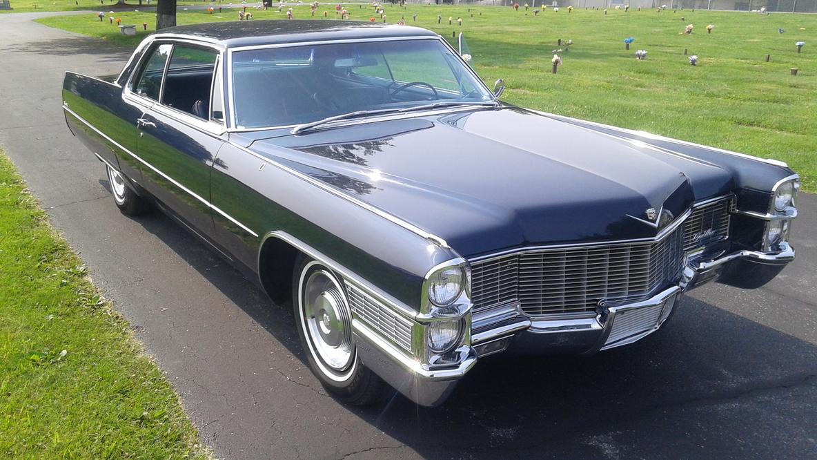

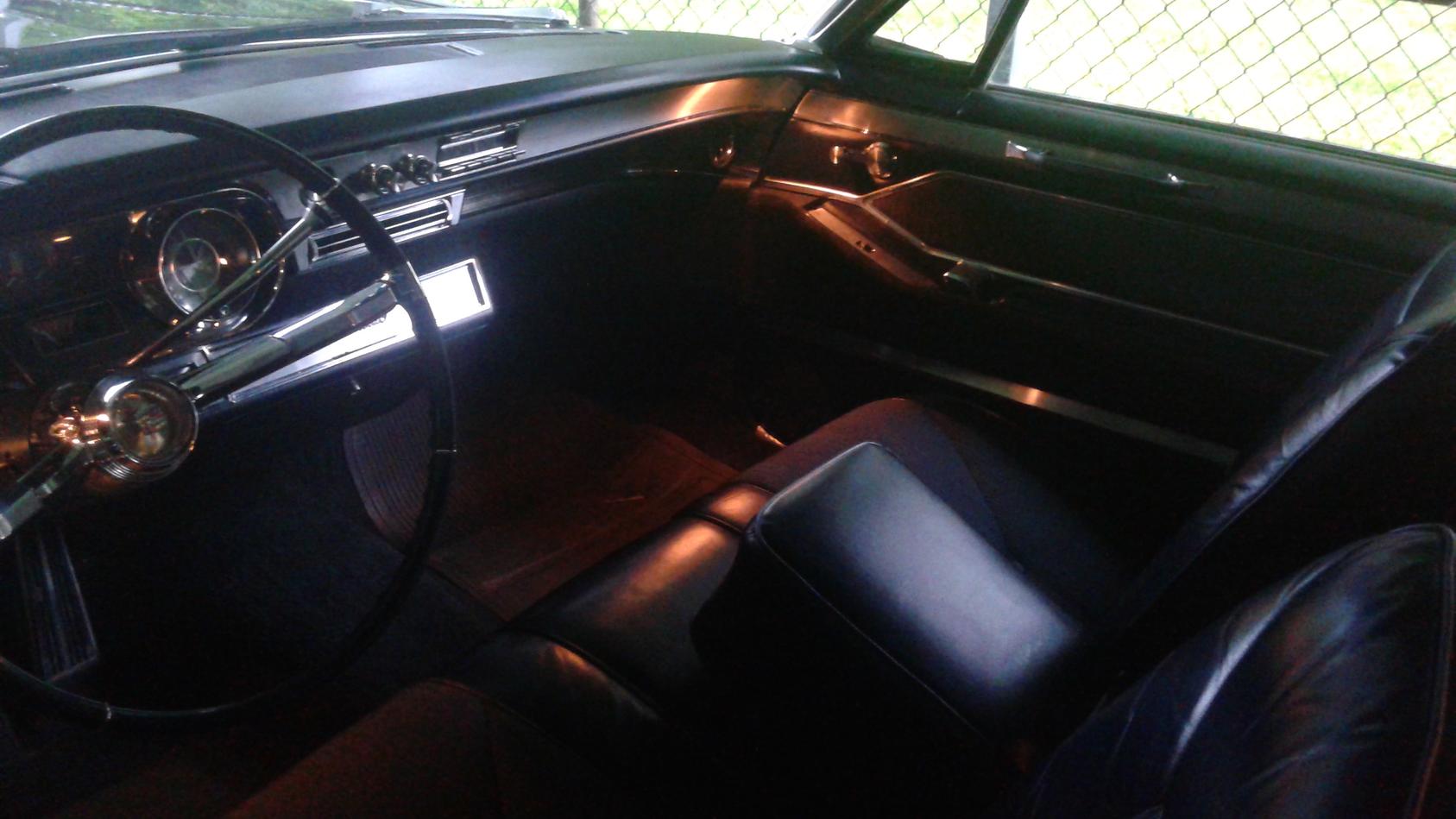

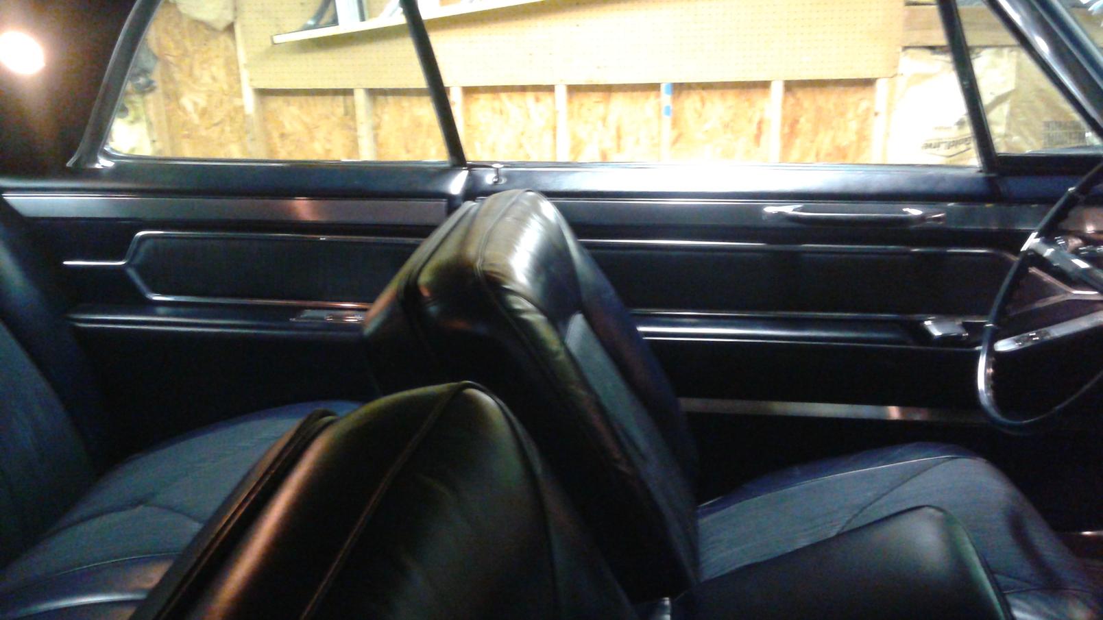

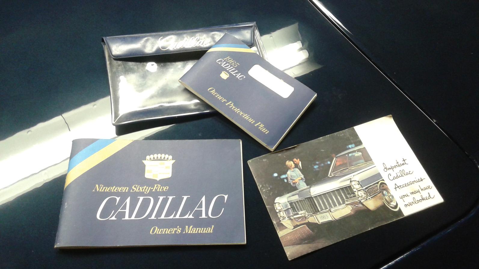

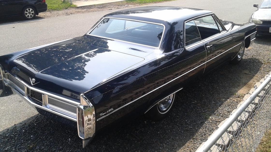

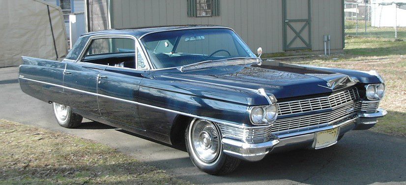

Its a 65 with 69k original miles. Car was bought from the estate of the original owner, a woman named Regina. I never named a car before but i named this one after her. Car is all original including all 4 T3 headlights, plug wires, battery terminals ect...

Regina is beautiful! Good luck with her.
