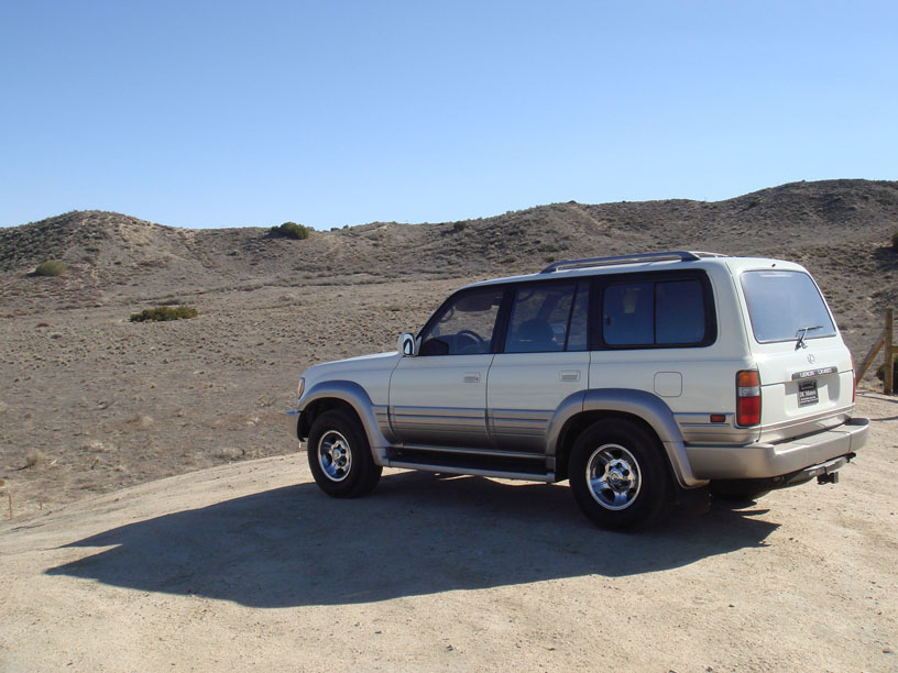

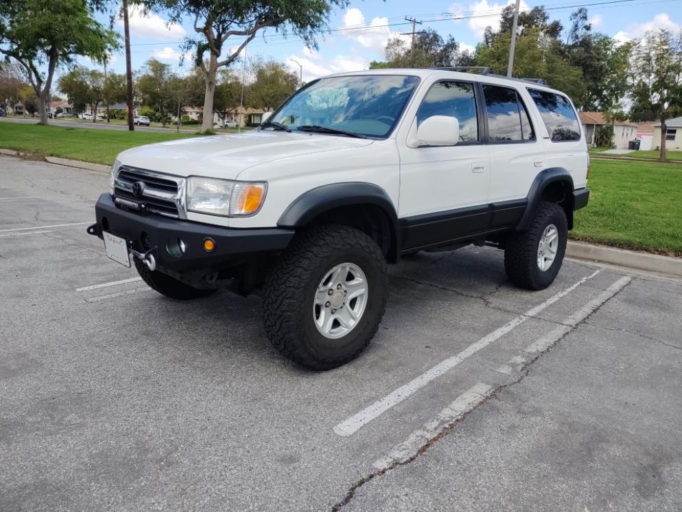

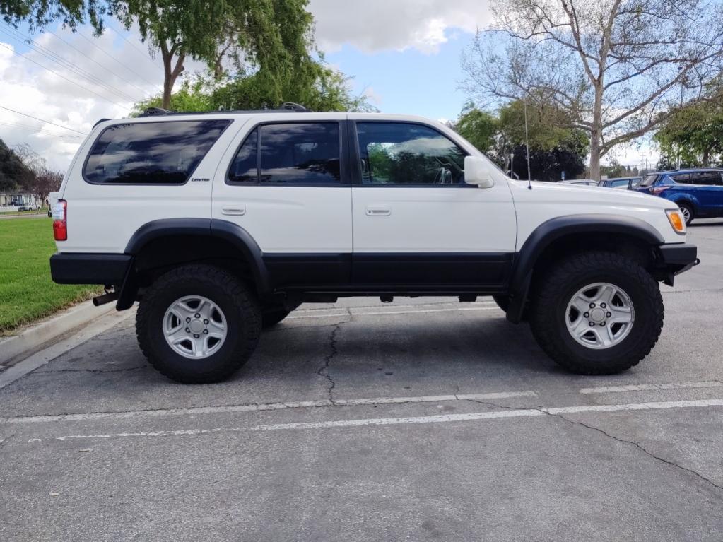

I have a built 99 4Runner (s/c, dual locked, dual cased, blah blah blah) and had previously built a 97 LC. The LC was bad to the bone, no doubt about it...35s triple locked, etc...never failed, went over every obstacle and was a head turner. Bought for 5-6K, built and enjoyed for a couple years and sold for 17K. Still had the original motor with 280K+ or so miles. The market for LC's is crazy and every time I was out and about I would end up talking to 2-3 folks about it that were staring and taking pics. Proud daddy moment of sorts. The 80 is much bigger...so parking might be an issue if you have a small garage (assuming you garage it). Also, because of it's size you are going to get more scratches/dings on tight trails if that is an issue.
With that said, parts are more expensive than a 4Runner. It was more comfortable for my family of 4 for the space but was louder and less comfortable on the road than the 4Runner. In the end I could only keep one and my love affair with my 4Runner was much older and I think I made out pretty good with the sale of the 80. I would strongly consider your needs/goals and base your decision off of that if this is a purpose based decision. If you are just having a mid life crisis then practicality doesn't matter...buy what you want, enjoy it and sell it later.
A couple pics of the 80 and a the 4Runner up in the air.
Those pictures you added make it so hard! Gahhhhhh I love that J80 and your Runner! Thankfully the wife said finish my current Non 4X4 4Runner and build it for a daily driver, fishing etc and we can figure it out the next step about a J80 or maybe 4x4 Sequoia. My wife drove my runner for the first time this past Monday and she said "Nope, Keeping it" she likes driving it especially with the lift. Thank you for your input and those sweet pics! Might have to use those and my wallpapers now lol
