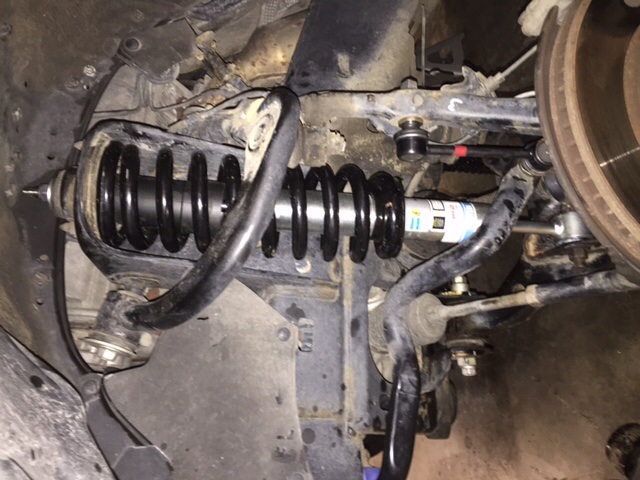

I finally got around to removing my factory XREAS system (208k miles) I went with Bilstein 5100's up front combined with new Moog V8 factory replacement springs. I was advised to go with Bilstein HD shocks for the rear as I still have the leveling air system in place back there. Thank you Ark Swamp Rider for all your help and everyone else on here that posted how-to threads and videos, made the removal and instal process relatively easy.

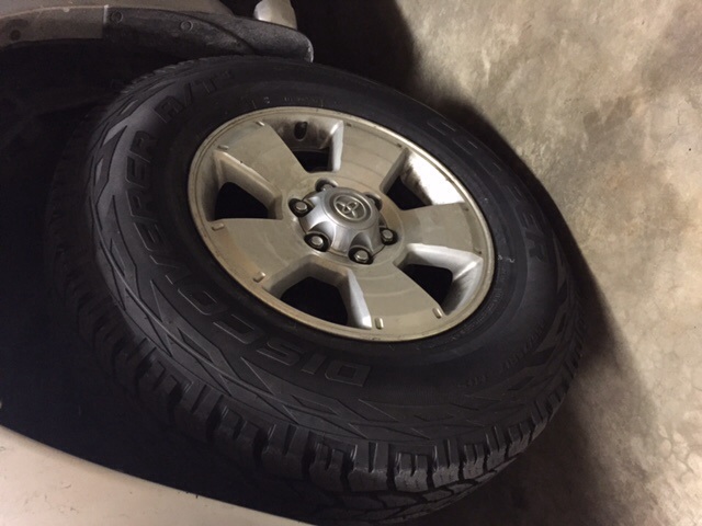

Tire wise, I went with the Cooper Discoverer AT3's in 255/75 17

Complications: the front cams on both lower A-arms were frozen, no matter what I did I was only able to get the arms to swing down for strut and spring removal/replacement but wasn't able to effectively move them for alignment purposes. Rear shock top nuts were not coming off (think of the age and mileage) so I used a sawsall to cut the nuts off just above the top bushing washer which proved to be a huge time saver in the end (new shocks had their own hardware)

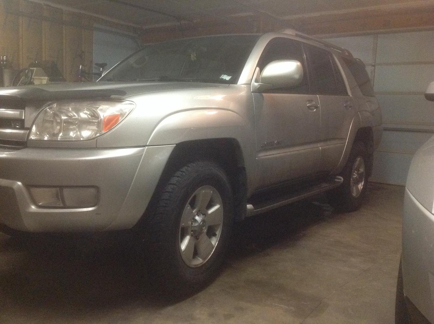

Not a good pic, runner is dirty and we have about 6" of snow outside at the moment.
