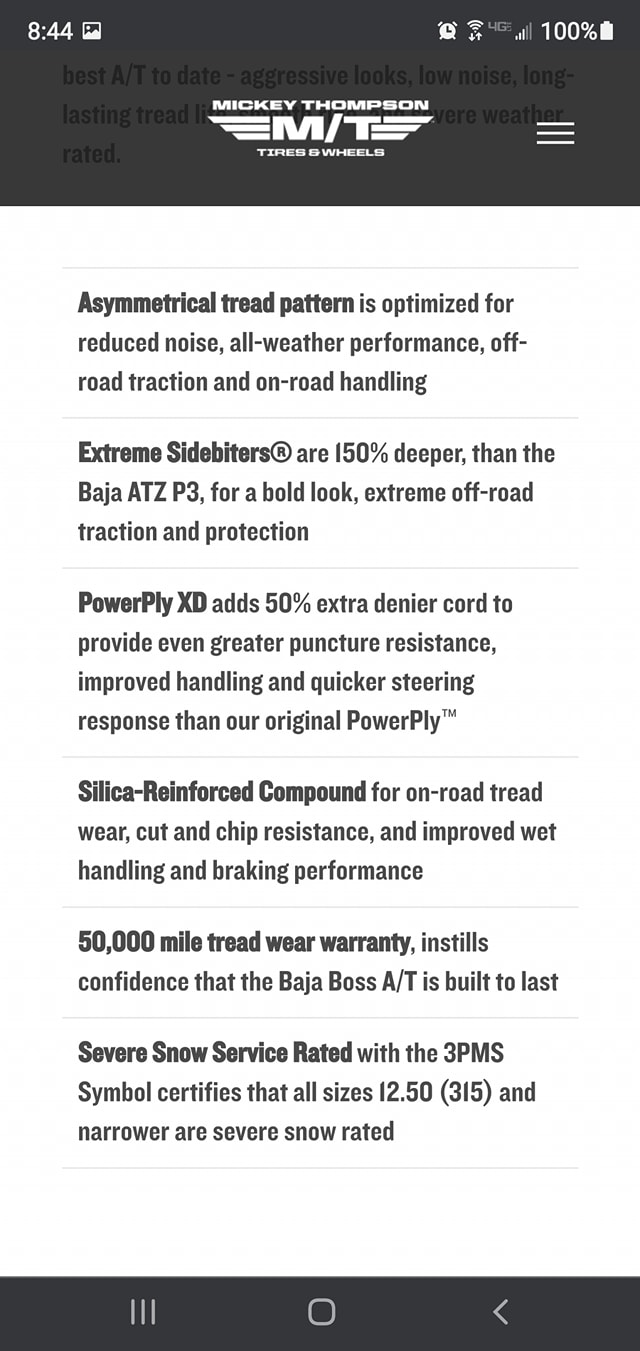

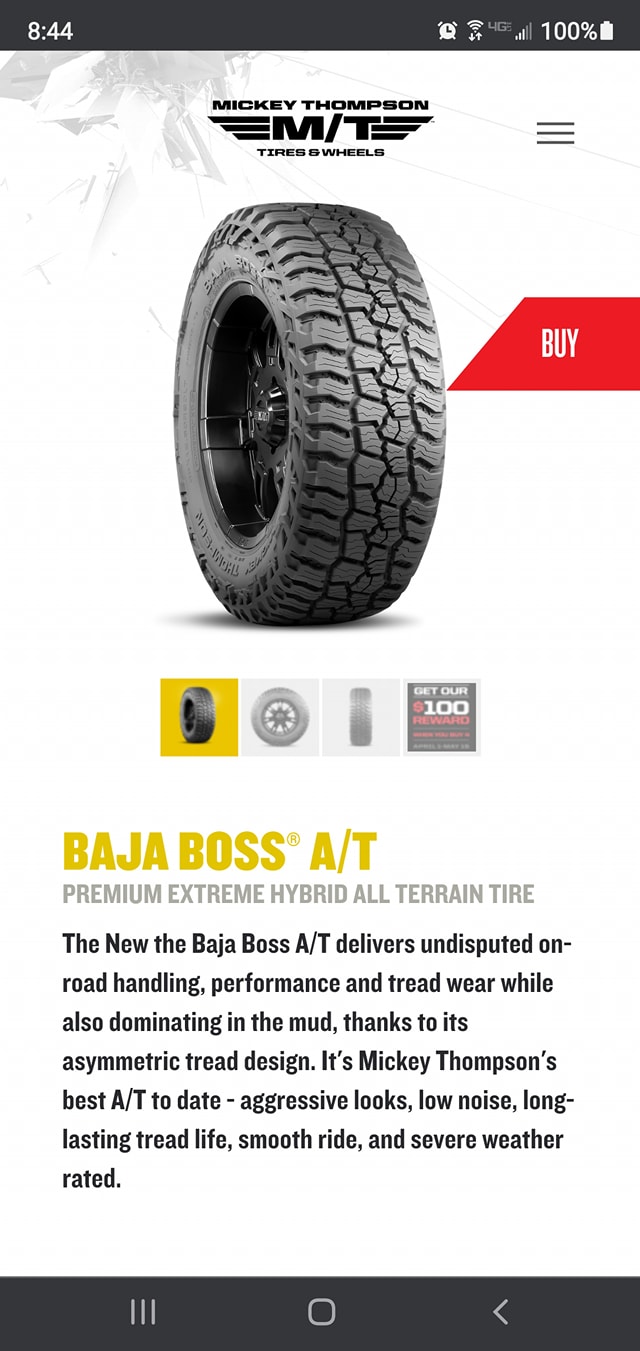

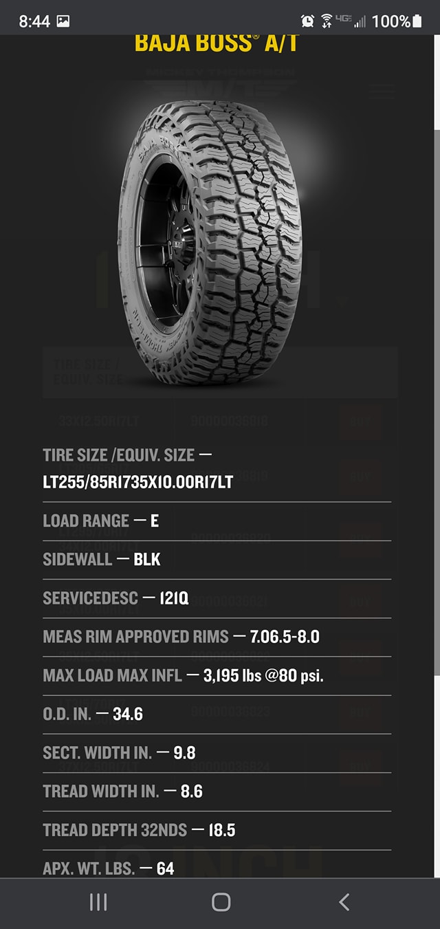

Coming from Nitto Ridge grapplers that have served me well.
Looks like another choice in the Hybrid AT/MT tire category.
Some great-sounding features on paper.
3peak snowflake rating
3 ply sidewall
Nice tread depth compared to Ridge grappler and New Toyo AT3's
Very intriguing size of 35x10r17
Priced around the middle of the pack
opinions? Anyone with pics on a truck?

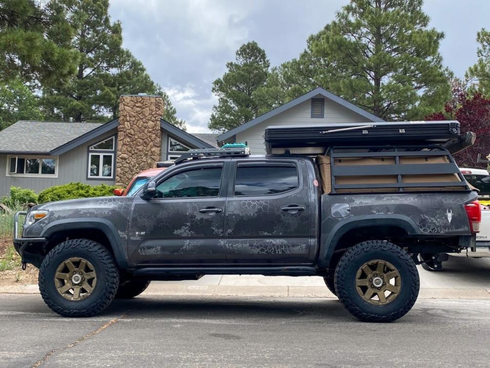

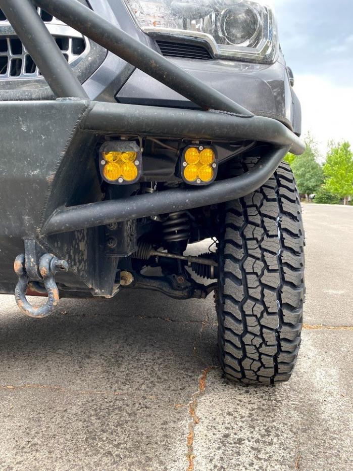

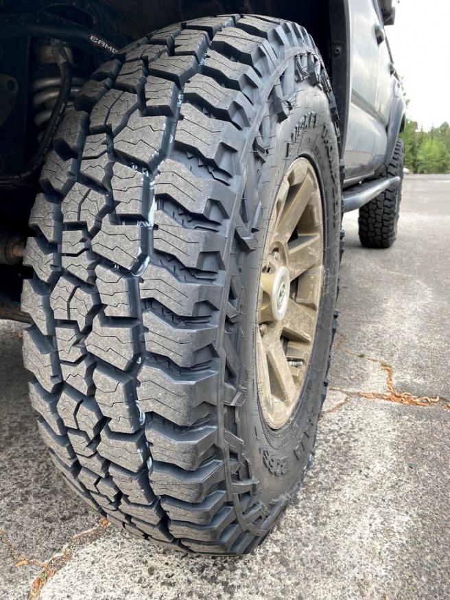

Agreed, all the reasons this tire has my attention. Id really like to see what this 255/85/17 tire looks like on our trucks.. seems like a great compromise of height/weight but is it too skinny?
Just sourcing out the best price but it looks like I'm gonna go with this tire and this size.
Found some excellent pictures in the Skinny tire mega-thread on tacomaworld.com
The SKINNY on skinny tires | Page 214 | Tacoma World
Anyone else go this route? Id like to see more tall skinny's on 4runner pics.
