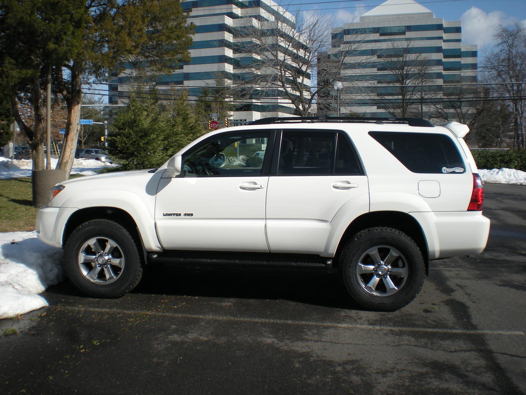

This morning, I'm getting 275/70/18 Good Year Wrangler Silent Armor tires put on the T4R. I can't wait to see the new boots! I'll post new pics.

Here is my T4R with Cornfed 3/2 spacer lift and 275/70/18 Goodyear Wrangler Silent Armors...

Unscrew the front liner and pull it forward. I have the same size tires and that what I had to do. I will later drill some new holes onto the liner to hold it into place. I'm using duc tape to hold the liner in place for the time being.
i followed the instructions from JA's site for trimming. I'm still rubbing a little, but only at full lock.

Actually, the pic was taken in Tyson's Corner. Let me know when you are planning to move back and need to purchase/rent a home. I'm a part time real estate agent.
