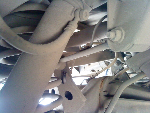

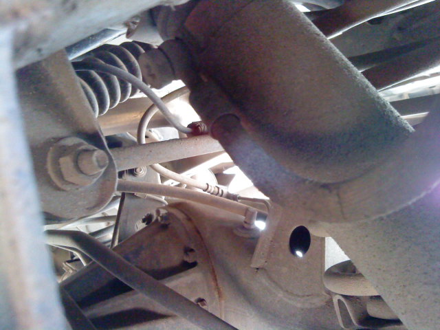

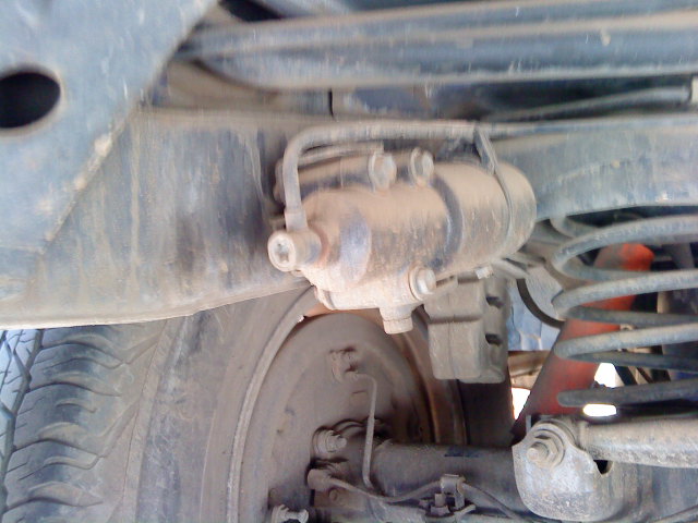

here are some pics showing hoses running from the rear shocks to the cylinder tucked near the left rear wheel. The front wheels have a similar setup with the cylinder located behind the radiator. The whole thing is definitely stock, no appearance of an aftermarket install. I did some research and its not X-REAS. I did not see any electrical connections to the cylinders. Any ideas?

In all honest it looks exactly like a remote oil reservoir for the shocks. Being an 01, your right in it is not the XREAS suspension. Very interesting though to say the least. Hopefully someone else will chime in with a more concrete answer. Good luck in your findings.

Sure looks like an oil reservoir to me. If you hit a bump and continue to bounce a lot is a good sign that the seals are leaky or less likely, the valves need to be adjusted to your taste. When you get a chance clean the shocks up to see if there is still a model number on it. You can google the model number and with a little luck you can find out the specs on it. If you do need to replace them, and want some good ones, get some Bilsteins. They are more but they are also great.
Ok, I found out what the thingy is (kinda sorta). Its an air/gas reservoir for the shocks, and adjusting the amount of air varies the ride quality of the shocks. So, from what am told, one side of it has air under pressure and the other side has the gas from the shocks and there is some sort of valve in between. Pretty weird, eh? Anyway, tomorrow am cleaning the whole area incl the shocks to see more detail, maybe there is a dial that says firm or soft!!!!
