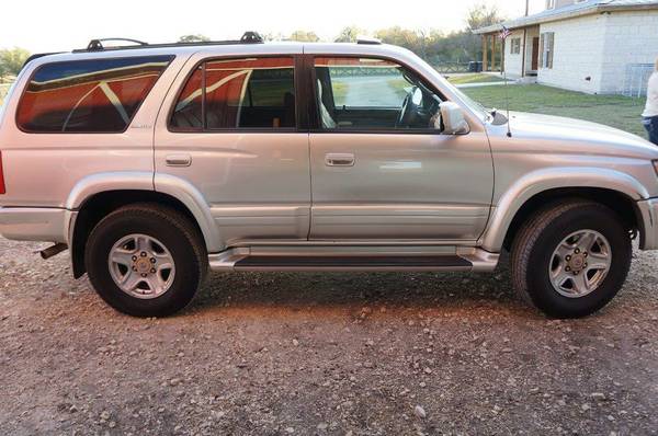

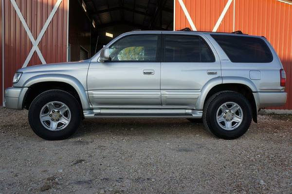

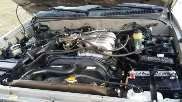

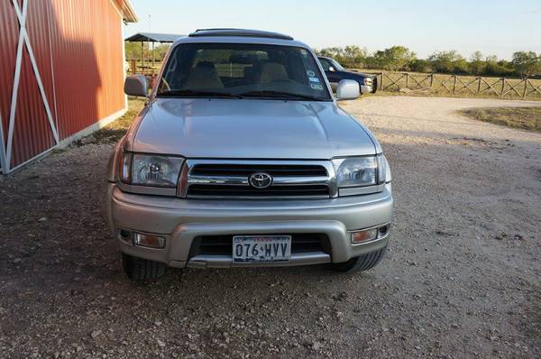

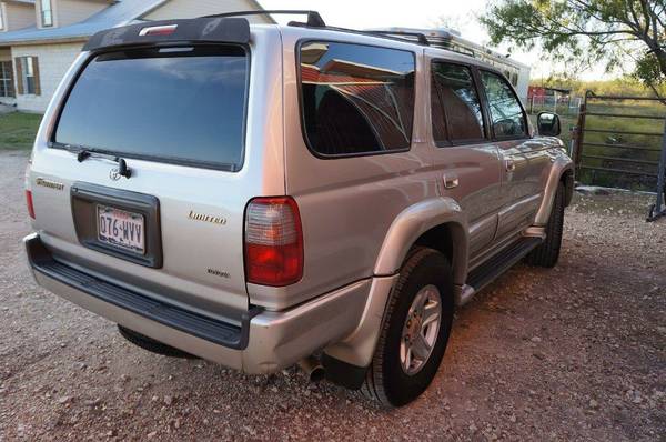

Here are some pictures of it
Here are some pictures of it. I am getting the oil changed and the tires rotated and balanced as I type this. The only thing is that the previous owner was a smoker and it smells like old crappy cigarettes and I hate that but I am going to clean the interior a 3rd time when I get home later today.

Nice! If I'm not mistaken, I believe your truck has had the radiator replaced. Which is a good thing. Mine is not brown like that. Could be mine has been replaced though.
