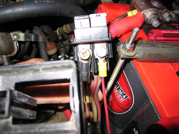

The fusable link is hooked up to the 80 amp fuse. These fuses are bladed and the wire from the battery (the fusable link) is screwed into the screw that holds the blade of the fuse to the assembly. You have to push the assembly of those two fuses downward to get to wire. To do so, you need to compress a clip in on the side of that two fuse assembly (one 80 amp and one blank).
This first photos shows the fuses and clip. Ignore the second fuse. I installed it to feed an auxillary fuse panel. You probably only have one fuse in this area.

Thank you! I'd been battling with that for a few hours, and although I tried pushing it down, it was pretty stuck for some reason. Anyways, it worked and I'm back to running. Thanks again!
