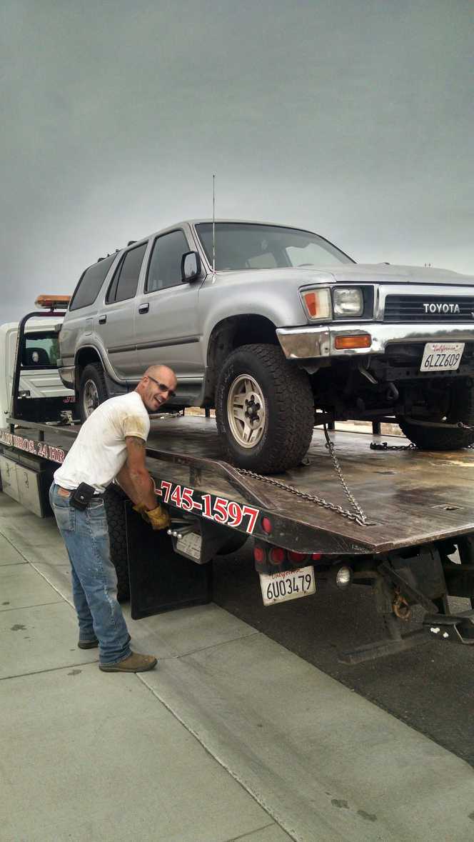

Just picked up my first 4runner the other day. Its a 92 with the 3.0. Got a sweet deal because its not running right, apparently the owner just put in new waterpump, injectors, and head gasket, but had to sell it before getting the timing straight. Its been a couple years since ive adjusted timing, anyone got any tips or links to a video, I saw a couple on youtube but they seemed to be for different engines.
