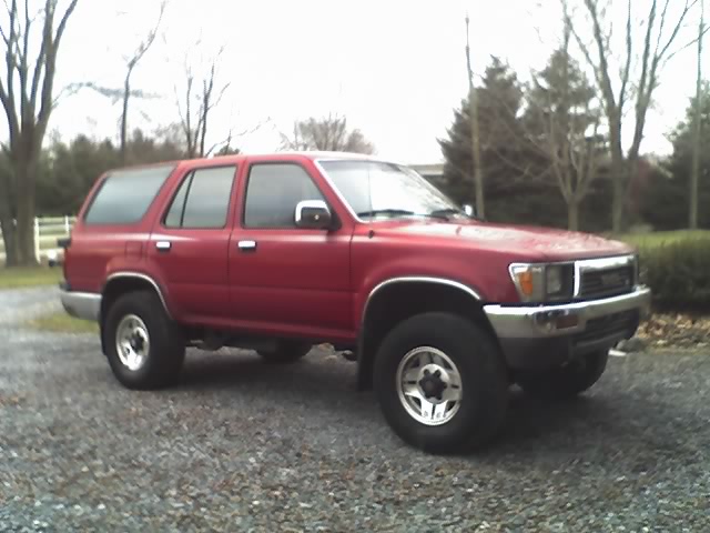

So I just bought a '90 4Runner and thought I'd check in. I have a feeling I'll be turning to you guys for advice and answers quite a bit.
A little about me: My name's Ryan, I live in Hampton Roads, VA and this is my first Toyota truck. Not my first Toyota, but my first truck. I'm a donating and contributing member at Maxima.org, though I think the Maxima is going to be my wife's now.
The 4Runner is a 1990 SR5 5-speed, red for the most part. 151,000 miles and apparently used for farm work becuase there's hay all over the inside.
Already I've figured out that the clutch slips under heavy revs and the throw-out bearing should probably be replaced when I do the clutch. The sunroof opens but doesn't close, the rear hatch doesn't open, the rear window goes down but not up, and every speaker is shot. Mechanically, she feels great though. What are some common 4Runner problems that I should keep an eye on?

looks like you don't have any rust, thats my biggest problem. The rear window not working properly is a very common problem, i bought a new tailgate off ebay.
Well, there's a little bit of rust bubbling at the top of all four wheel wells and a rust hole in the rear bumper, but no structural rust from what I can tell. I fixed the rear window, it was just heavy corrosion on the motor connector. I haven't fixed the sunroof, but I did manage to find the manual open/close screw so as long as I don't ever open it again, I should be fine.
