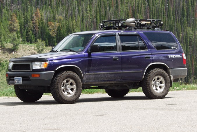

4" lift and 33" tires are pushing it without powertrain mods, although there is a TRD supercharger to help out. I never lifted my 3rd gen, it was phenomenal offroad without any help. Pic included :)
