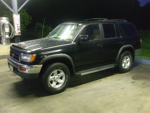

well first things first, hello to thee fellow RUNNERS, lol. i bought a 97 SR5 2WD 3.4 AUTO it looked and performed nicely. until not even a month later the tranny went out. replaced it. then rear shocks were out (so i thought). both rear shocks replaced with Rancho RS5000. i noticed they were shorter than the OEM set-up. drove on them for a month and they comfort about 25% better but still having that feel like the springs are worn. plus it has this sagging stance in the rear. anyone know of any helpful advise? this pic shows the same day when installed, now it sags alot. the bumps feel very hard when driving.
The sagging on the 4runners is a common problem with it seems with every model...but it is easily fixed. If the springs on the 97 are original...just change them. Rear springs aren't that expensive. If you are going this route though and the vehicle isn't lifted then you may want to consider one the lift kits out there and just change everything at the same time. Downey makes a kit, Cornfed, OME there are many available if lifting is an option you want. If you search the forums a bit you will find that the sagging problem is common with all of the older runners. Just wear and tear on the suspension eventually takes its toll.
i am wanting to lift it a few but not to much. my wife drives it with our two lil' boyz still. can't get her away from this TOY. what can i do about the recall on the rear springs? is it better just to go with aftermarket springs anyway?

good looking ride
see if the recall for the springs was done on your ride. If not get Toyota to replace them for free.
Old Man Emu is preferred by a lot of folks. With or without lift. Possibilities are endless.

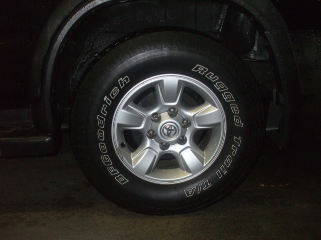

i bought these wheels and tire combo off of a 2006 Toyota Tundra. let me know what you guys/girls think of them. :roadkill:
Where is the picture?
Oh you mean the one you already posted?
They are alright. How much did you pay for them?
I think I would have gotten the FJ wheels or the 2007 Tacoma wheels if I was staying in the 16" range.
i payed $225 for the combo on craigslist.com they were better looking then the enkei's that were on there when i bought it. 30x9.50x15 i'll post a picture later. dont have one yet.
