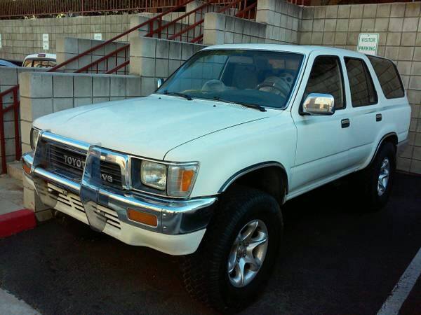

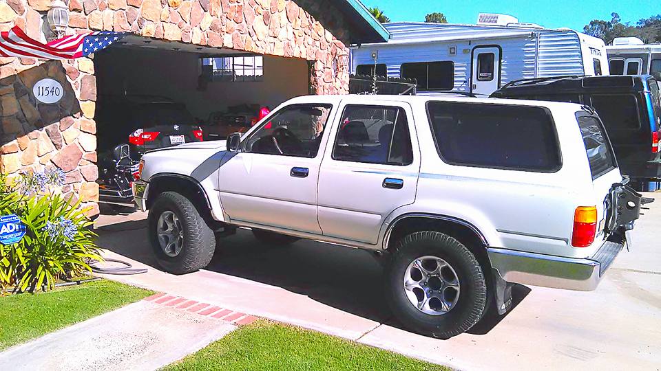

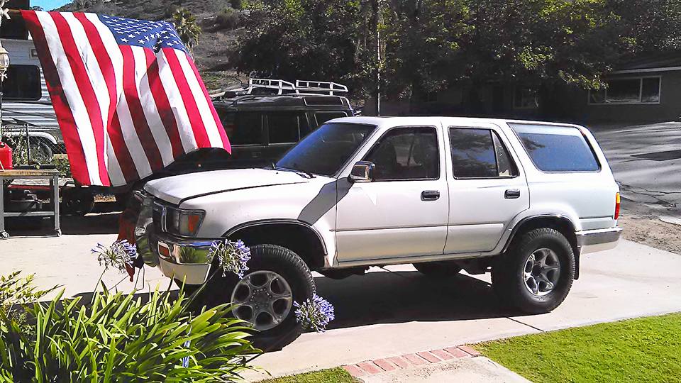

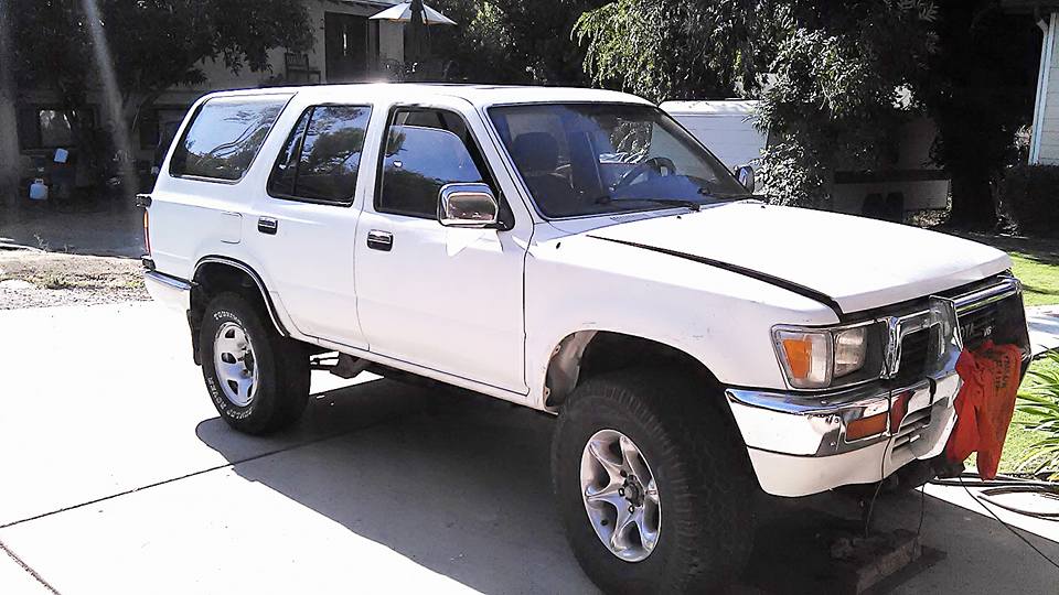

USNavyOrdnance is on a distinguished road Hello from SoCal, 90 SR5 4Runner 4x4
Hello ya'll from Lakeside,Ca. (San Diego). Active duty Navy here I just acquired this 1990 4runner SR5 4x4 with the 3.0 and auto trans. She's been sitting in storage for 10+ years and hasn't been started in 5+ years. She has 212k miles and turns over so that's a good sign thus farI guess... Lol. Fluids look good with no bad signs but I can tell that the rad had a leak. Gotta put a new rad in. I plan on doing a full rebuild/overhaul once I get her started and know what she's up to. Flush all the fluids then tear her down. I'm a gear head and very mechanically inclined. I own/operate LZ Custom Cycles as a side gig and have built several rigs from Harley's to a 1ton K5. My current off-road rig is a built 99 Disco 1. Same situation with that rig, brought her back from the dead. This is my first time building a Yota so I'm looking forward to it. Firm believer of an engine is an engine.... Just gotta get use to the Yota terminology and location of all the relays and what not. I already printed out the manual (we get them for free on base) and have studied it up some. I plan on bringing her back to life and building her up more mechanically and cosmetically (making a rack and bumpers) then giving it to my Son who will be driving next year.
With that out of the way, maybe you guys can guide me in the right direction. Already did the searches but still like to ask directly. Please bare with me...
The rig turns over beautifully, has spark(double checked coil and each individual wire for spark), has fresh fuel, pump kicks on and works(tried jumper method with paper clip and verified thru cold start valve and at throttle body) and timing belt is not snapped. Checked all the fuses and reseated all the relays(even heater/ac relays) and still no start up. Not even with starting fluid! Seems to me like I may have a bad COR or ECM? Has a fresh battery and fuel. I did have to wire in a new ignition switch as the old one was broken but it went in with no issues. Has all the proper indents and acc, on and start. Dash lights come on as they should when in on position and stay on when attempting to start as they did before. Other than the relays or ECM, I'm at a loss. Any Yota guy suggestions? Thanks in advance.
