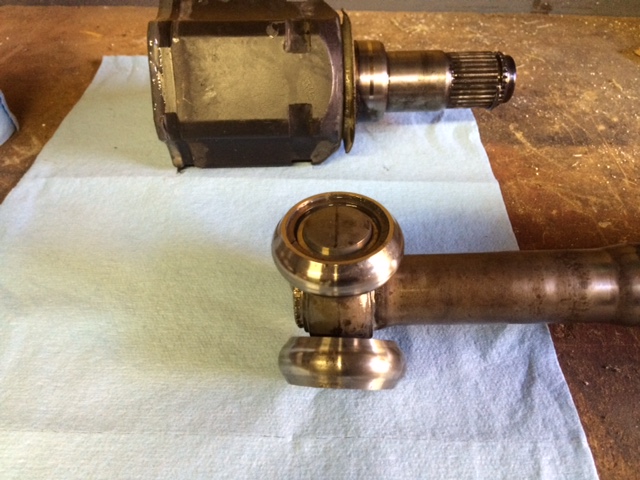

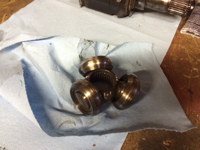

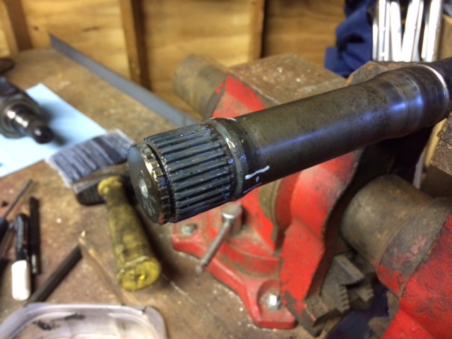

Other than the timing belt, rebooting my axle was a more complicated job.
Looks like you have been busy.
I know people don't want to reboot the cv axles because its messy, but I like to do it knowing that there is the right grease in there.
How hard was it? I have rebooted axles on numerous Audi's.
Its not bad at all really, its just tedious, messy work.
Not too bad, the hardest part for me was that I forgot to take the C clip off the end of the joint so I hammered away with the punch for a while forgetting there was that clip. Once I removed it the joint practically popped off. I bought the rebuild kit from Napa.
