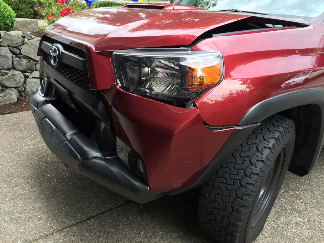

Umm... Not true... No airbag deployment. And there was no frame horn damage. (just about $6K of OEM body parts, paint and labor)
Pics of your inner bumper? (that's what we're talking about - not the plastic cover, the plastic has no value at all in impact resistance). Normally the aluminum bumper must have failed if whatever you hit caused damage the hood like that. Hard to tell though. If you hit something taller than the inner bumper it might have just missed it entirely. Kinda looks like that's what happened here. Seems hard to see how you can collapse the front aluminum bumper and not set off the airbags.

Note that the frame collapsed and the bumper didn't. So... umm... true?
