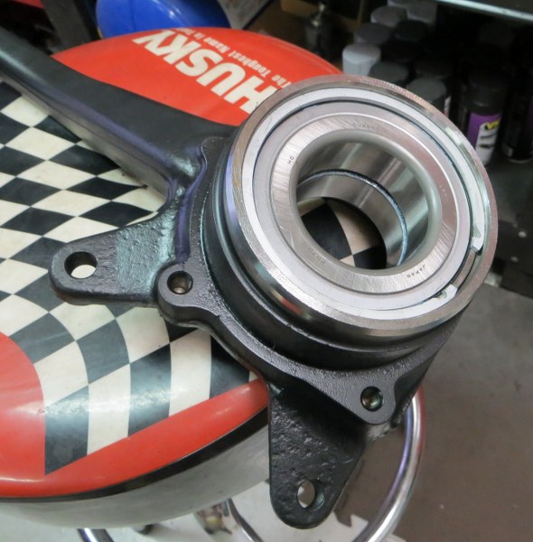

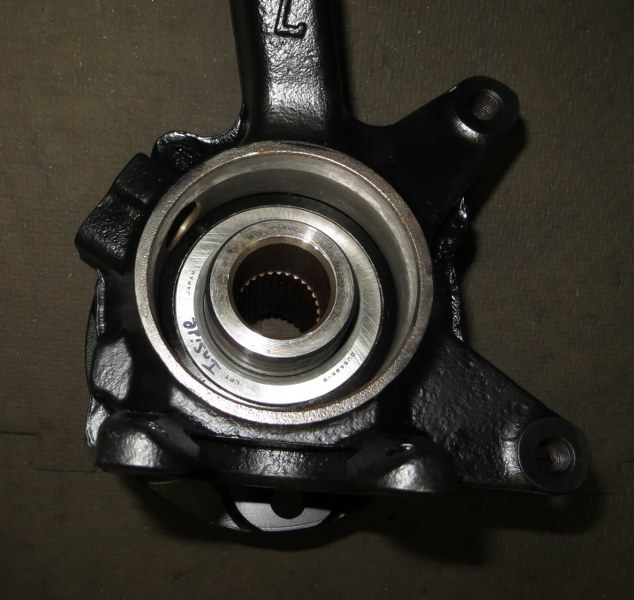

Black plastic to inside, metal shield to outside:

I wonder why they designed it this way. In a wheel bearing application, the rubber contact type seal is almost always superior to a metal shield longevity wise (except for high speed or energy efficient applications). I noticed some aftermarket front bearings seem to use rubber seals on both sides whereas other brands follow the OEM design.
