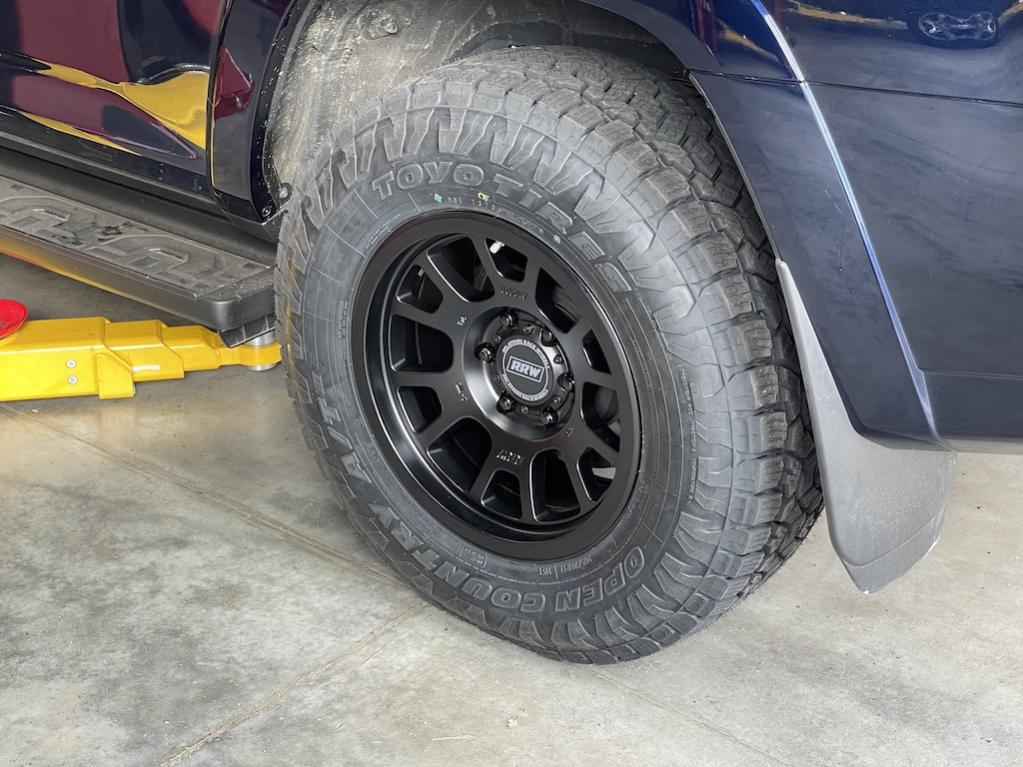

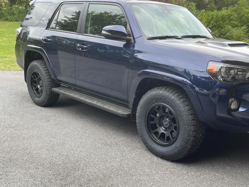

Picked up a new net of wheels and tires for my 2020 TRD ORP, I liked the RRW Wheels and Toyo OC AT3'S tires. Went with zero offset and stock size tires because my 4R has KDSS and didn't want to mess with it since it handles so well.To my surprise I didn't really notice any additional road noise over the factory Dumbflop tires, also the Toyo's seem to handle better and vehicle does not wander around on the highway.Now if only I can get Tire pressure warning light to go out.
Keeping factory wheels and Dumbflop tires so I can swap out as needed.

With the stock tire size, how is the fitment with the 8.5” width? I haven’t even really considered anything that wide.

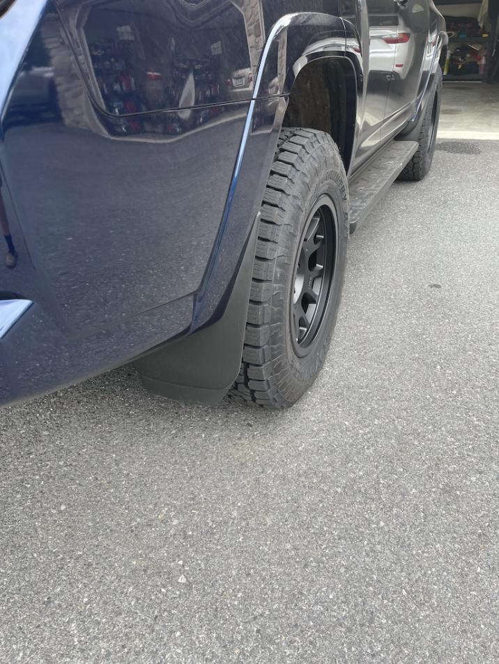

They look awesome compared to stock wheels and tires, had a very slight rub at full right lock, ended up loosening inner fender liner lower 10mm bolts and pushing liner forward and tightened back up. Did both sides and no more rub. Pictures don’t do justice, if anyone orders these wheels from RRW make sure you order the 12X1.5 Extended thread spline lug nuts, factory lugs won’t work.
