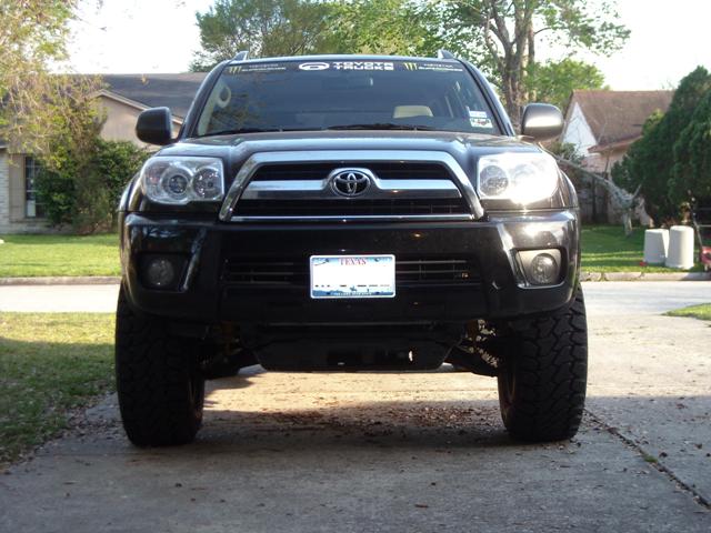

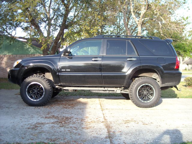

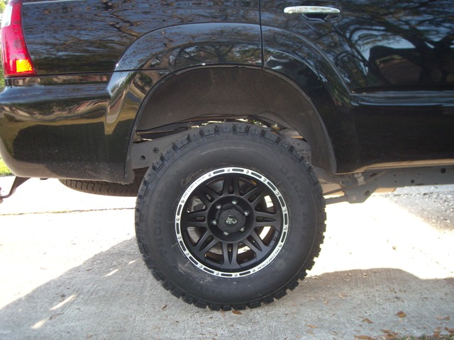

Just got my new tires and wheels installed. The wheels are 17" X 9" Pro Comp 7105's with 6mm offset and the tires are 305-65-17 Mickey Thompson Baja ATZ's. They did require relocatrion of the inner fender lining forward 1 3/16".

Looks awesome. You will get a lot of compliments about all the black as well.
Great choice with the wide 33" MTZ's.
You've got some body lift there as well. Any issues with rubbing on the body mount? Is the offset + or - 6mm?
Thanks for the compliments. The wheels have a -6 offset and i have 1.5" bodylift. No, at this point it does not appear that the wheels will rub the body mounts. Although i'm not against trimming them if its needed in the future. Right now even with the wheel turned all the way there is approx. 3/4" clearance between the wheel and the body mount.
Thats good to know. A lot of members want to know about rubbing. I've always been an advocate getting the right offset wheel for the tire you want to run versus adding wheel spacers.

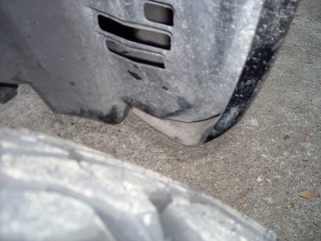

I did move the fender liner forward and trimmed just under 1/2" from the bottom of the fender.
