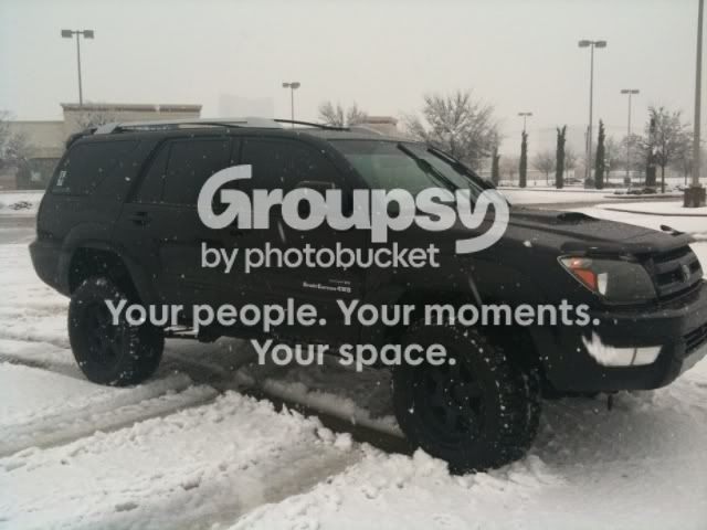

The setup you are asking about sounds pretty much identical to mine...
3/2 Cornfed spacer lift with 275/65/18's is my current setup

My 2 cents - the 3/2 spacer lift has worked out just fine for the last 2-3 years or so. Be ready for a harsher ride over speed bumps and potholes. If I had to do it all over again, I would have ripped out my XREAS on day 1 and invested the money up front for the right stuff the first time. I'm currently saving up for ICON coils, UCA's and 2.5 Resi's in the rear (overkill I know). But I'm ready to get rid of the spacer kit because it has started to sag in the front pretty bad. OME and Bilstein 5100's are reputable and have received a lot of feedback by members both here and on Toyota120. Good luck!
