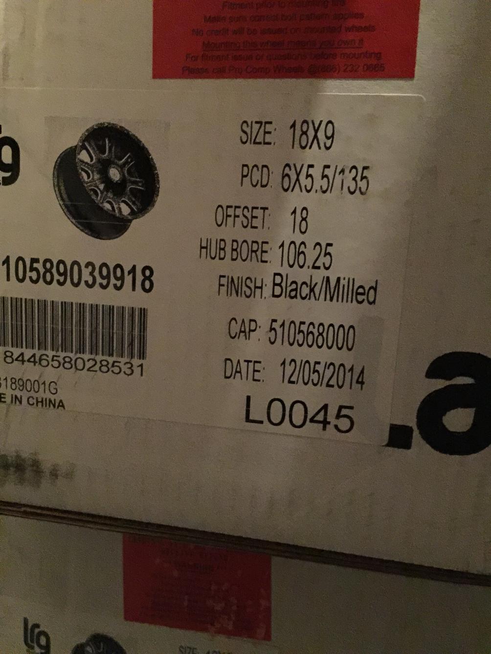

So i got the wheels attached at a really good price. But i was wondering if i am going to need spacers to make them work. Could anyone tell me if they will. thanks
Lrg Rims Part 10589039918 - LRG 105, 18x9 with 6 on 5.5 and 6 on 135 Bolt Pattern - Black and Milled - 4 Wheel Parts
Hard to say with that +18 offset and 9 inches wide. My best guess is you will need spacers. If not spacers then it will be really close to the UCA especially if you have stock ones. But nothing spacers cant fix! And with spacers and that wide ass wheel your stance will look BA. :naughty:
But no better way to know than jacking up your rig and test fitting them. Post up some pics when you do.

man it kicked my ass to do it myself earlier to make sure that but i forgot to check that part. but i did it on the rear. but what i plan on doing is go to Discount Tire and have them check it for me before i buy the tires from them. Plus with my 2.5 ton floor jack couldnt get the front up using the jack points. so i figure paying discount $20 is money well spent.
If I calculated it correctly you'll lose 1.21" of clearance on the brake side
First off thanks for doing that. But sorry if I sound dumb, I'm new to after market wheels, what do you mean by what u calculated I'm lost. Thanks for your help.
You can take new wheel specs and compare to stock and calculate how they will fit in relation to original setup. For example if you were going from a 7" wheel to an 8" wheel and both had identical offsets the new wheel would be 0.5" closer to the UCA. Different offsets just makes it a little more difficult to calc.

I run a 9" wide wheel but with a negative 12 (if I remember correctly) and that puts me right around 4.56" off backspacing. I have a feeling you definitely will need spacers.
My opinion don't buy if you haven't already unless the deal is that good and will cover the cost of a quality set of spacers (aka spidertrax).

Rule of thumb to remember....Positive offsets will tuck the wheel inwards and negative offsets will push the wheel outwards. In most cases (to maintain the same inner-clearance) anytime you go wider...you want to increase the negative offset to equal 1/2 of the total width increase.
For example: Suppose you're installing a 1" wider wheel. You're immediately losing .5" of inner clearance (and .5" of outer clearance). Using 2nd grade math you know that 12mm equals about .5". All things being equal on the wheel (except the 1" width increase)...you'll need -12mm of offset in order "Offset" the increased .5" of inner width. This puts you back to neutral.
In your case you added .5" of inside width AND .75" (+18mm) of offset for a total inside clearance loss of 1.25".
My bet is that you're going to most certainly need spacers.
