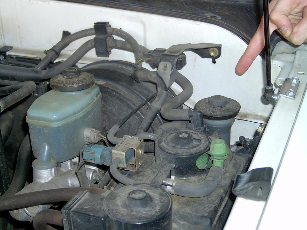

Welcome newbie! Get out your wallet we will have you spending the boat money in no time whatsoever. If you're going to be underhood a lot then I highly recommend hood struts.
Practical and stylin' at the same time....here is a shot when we did our clutch flush-you won't have a clutch fluid reservoir but this is where the drivers side strut attaches.
