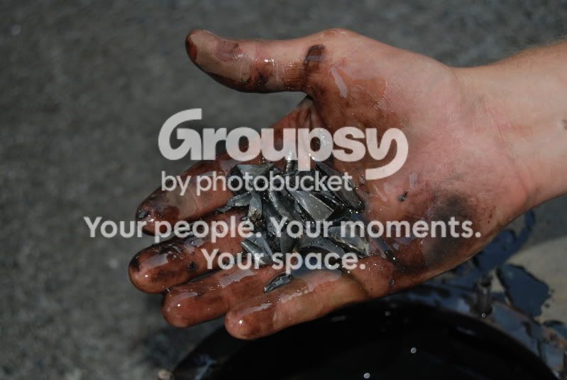

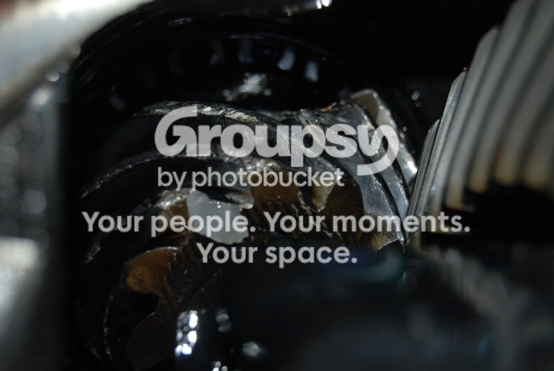

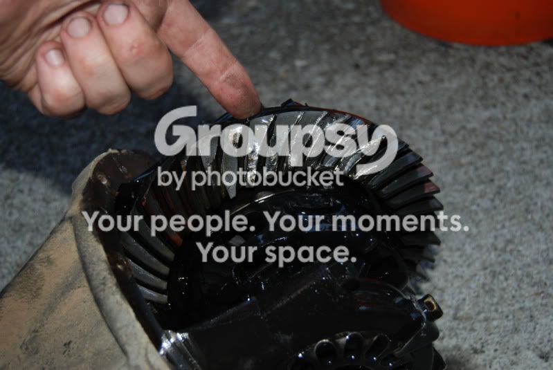

My question is, looking at the following pictures, do you think it's worth trying to get the diff rebuilt or find a used one out there somewhere?

I believe I would just try to get another 3rd member, and clean all the debris out . The whole assembly may be cheaper, though.
A used 3rd member is the easiest route as mentioned, but if the actual differential is still ok (spider gears, case, etc) then the cheapest route would be to just get a new ring and pinion.
Unfortunately by the look of all that metal the spider gears stand a good chance of being damaged too. Since you like to wheel your rig you might consider putting an ARB air locker in with new r & p.
I bought a good used 3rd member for about 225 shipped. just installed it 2 hours and 45 minutes total.
Had the same problem about two months ago and it was close to 1200$ CAN of parts to fix it. Pinion and gear, seals and bearings. Labor not included.
You should defenitely go with a used one.
Well the quote back from the shop on repairing is $950. The ring and pinion are obviously bad and the bearings are now shot as a result of it beating itself to death.
Since the only STOCK used units that I could find available so far with 4.30 ratio and the factory e-locker are in the area of $700 I think I'll spend a little extra and get the re-gearing done that I wanted to do anyway at some point.
