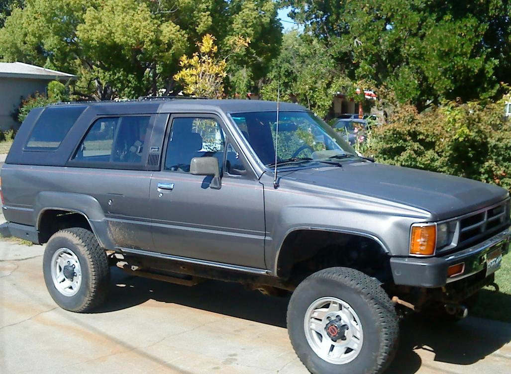

I'm a new user and here are some pictures of my recently purchased 87 SR5 4Runner. I've been wanting one for a while and got this with the 22r and 5 speed. couple of questions:

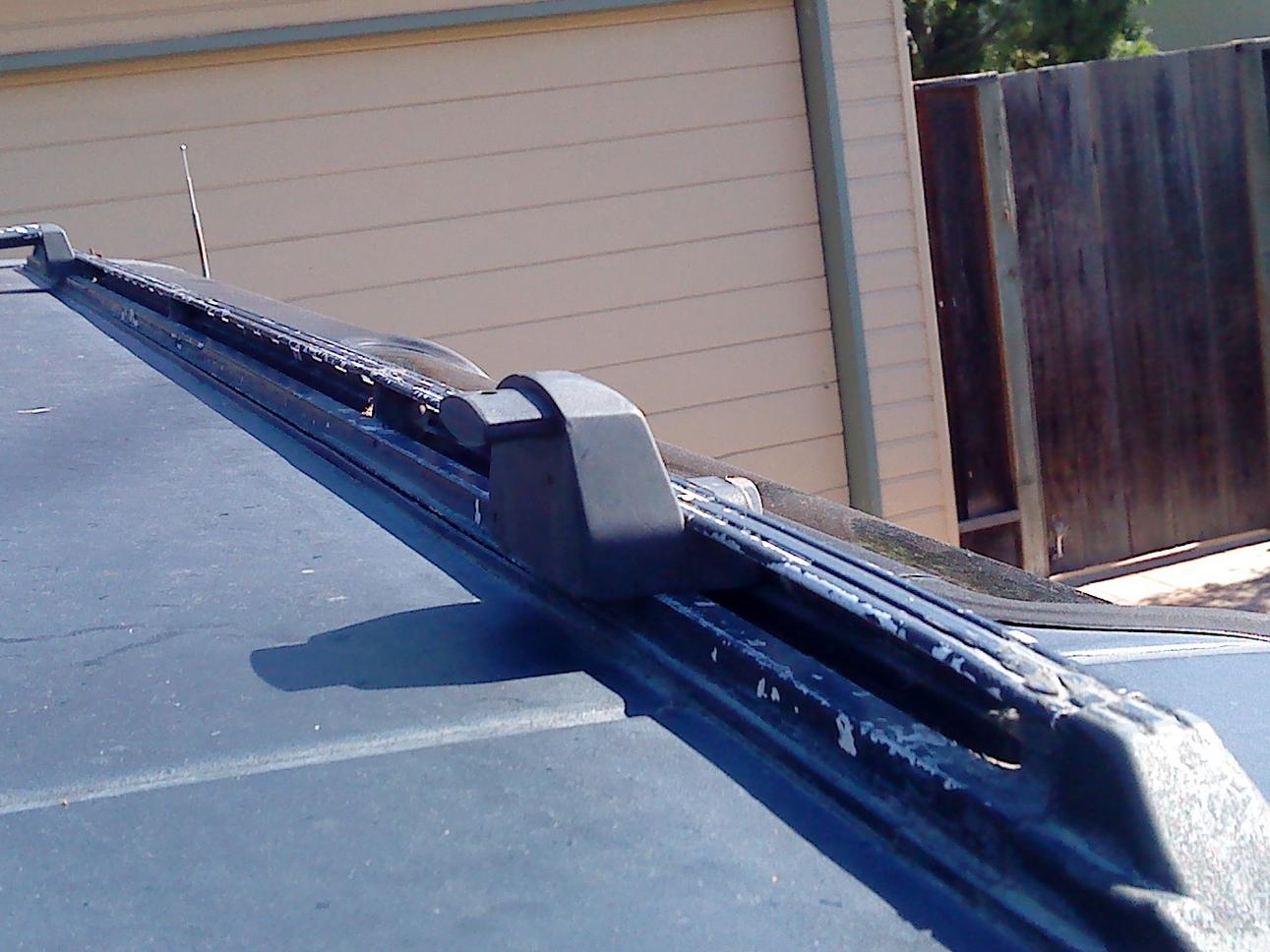

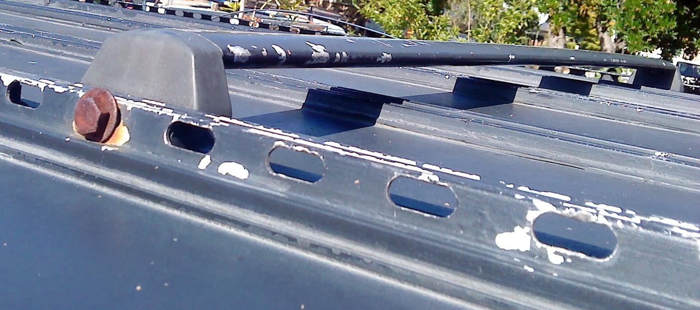

1) Is the roof rack in the photo original?
2) I'm thinking about removing some or all of the lift and going with 31 inch tires. The tires in the attatched pics measure about 28 inches. Does that seem like a good idea?

The rack does not look original, the 28" tires do.
What makes you think there's a lift kit, and why remove it to install larger 31' tires?

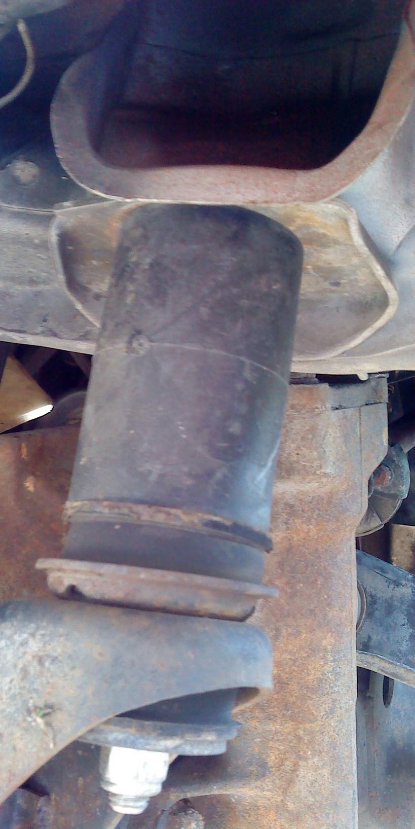

There is a 3-4 inch body lift. Spacers in between the rails and the body. I know that I don't need to remove the lift to get bigger tires but I wonder if I can get by with less lift. I don't plan on doing a lot of rock climbing but I do want to be functional off road. I dont want the truck lifted just for looks: so I am wonering how much lift I really need for functionality.
Thanks for the in-put. I love my "new truck" because it is so well engineered. This one is great because I don't think it has been wheeled hard but it did come prescratched and dented so I don't have to worry about keeping it perfect. I don't think that it has been wheeled much because the body lift is preventing the shifter from going into 4w-low. I'm thinking about taking some of the lift out by cutting the spacers. They do not look like they are neoprene so I may want to replace them anyway.
