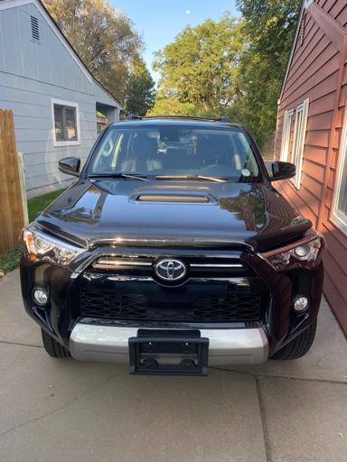

Stock - blank canvas. Only addition is the weathertech bumper guard. Mostly to discourage rocks from hitting windshield. Happened to me twice in the two months I’ve lived in CO from TX. Not sure why it’s so much worse here, maybe the off road tires on everyone’s cars hold and kick up more pebbles?

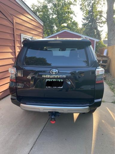

Next easy upgrade was to add a recovery point to the tow hitch, mostly to discourage people from backing up too close in parking lots.
Went with the motormic shackles hitch from Amazon because of the included locking pin. Several friends have had hitches removed in parking lots and just didn’t want to have to worry about it.

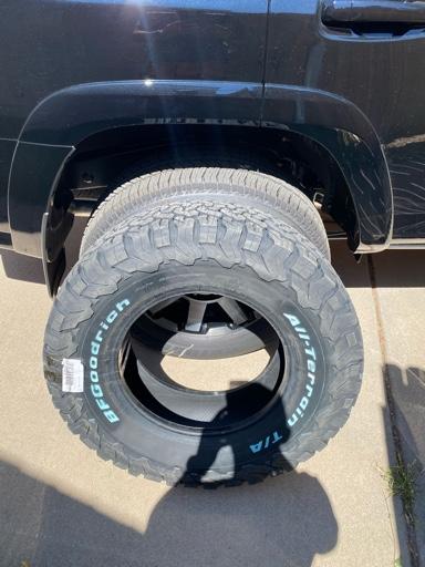

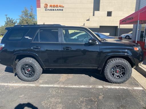

Based on reviews and the consumer report ratings of the OEM tires, and the proximity of CO winter I knew that I would be changing out the tires. I wanted to size up to 275/70R17 and knew the added weight would impact mileage long term. We plan on owning this car until it dies so it made sense to upgrade to lighter aluminum TRD SEMA wheels. The off road performance and looks are just a side benefit.
Bought the TRD SEMA wheels on Amazon $200 even each, got 5 to have a fully interchangeable spare.
The wheels I decided on are BFG K02s in 275/70R17. Unoriginal but they just seem to work for so many people and I didn’t need to get too fancy.
Installation done by Big O tires here in Denver for $70 total. Below is OEM tread compared to K02.
After install. Really changes the looks of the vehicle. Ride is a bit tougher at certain speeds, really only noticeable above 65 mph. Ride quality is quite good.
275/70/17s DO RUB AT MAX TURN!!!! The forums debate this back and forth. There is no issue with most daily driving but at max turn (notice it most when backing out of driveway) they definitely rub. Just in case anyone was considering this I wanted to register my experience because the internet was equivocal when I reviewed the forums.

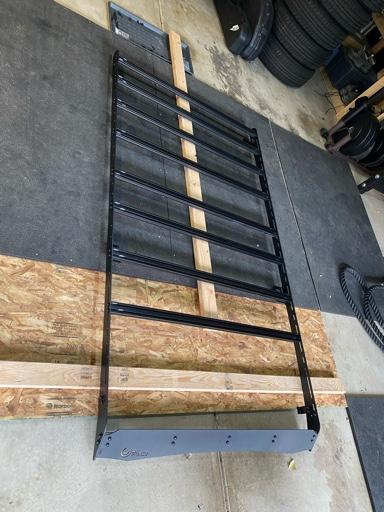

Prinsu No Drill Full Roof Rack also arrived. Wanted the Gobi stealth but couldn’t afford it. With this my moonroof will be minimally useful. Wandering if I can position the crossbars so that I can still enjoy the moonroof- at least until I can get the RTT.

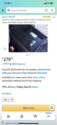

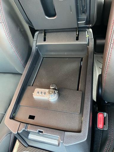

One of my favorite additions so far is this Toyota OEM console safe. Really nice to be able to throw valuables in there when going for a hike. I also keep my ham radio faceplate in there when it’s not in use.
Easy install. Genuine Toyota part. Perfect fit. Highly recommended.

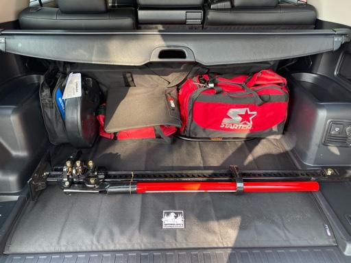

Finally got the Canvasback liner for the trunk and back of the rear seat. The factory mat wasn’t really doing what I needed and I also worried about long term durability.
Debated the Canvasback vs weathertech trunk liner for a while. Ultimately decided to give these a try as they are thinner and easier to work around. Pleased so far. Went with black with normal sticking. If I could do it again I’d get red stitching to match the rest of the vehicle.
Do you happen to have the part number for this?
Ohhh, first time I'm seeing the Canvasback and I like it. Can you a full view of the canvasback without stuff in the trunk or the trunk cover? Also, is this the Black color or Graphite color listed on their site?
Definitely going to order this for my '16.

Working on the Prinsu no drill rack. Note to others, it doesn’t come with the torx bit required for the screws. It also no longer comes with the weatherproofing strips for the roof (instructs you to cut and repurpose the factory ones) or the front wind strip (disappointing for $900 that they charge an extra $15 for a price of rubber tubing. Poor show).
are there any issues with it moving around? or is it secured?
