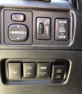

During this mod I wanted to move the power inverter over to the left but toyota made it difficult for whatever reason (probably to keep it simple for the assembly line folks)
Note the height of the protruding plastic on the left and the double slots in the dash that don't match up to this switch
Same problem on the right side...
This is easily solved using some snipping pliers and/or razor blade to shave down the plastic
Perfect! Room for another switch down the line...

Look at this photo and see if this location will work for you.
I moved mine there on my 2014. Same configuration as the one it came out of.
It will free up both of the bottom slots!

Ohh man. I'm going to move my power inverter button up top and the windshield (deicer?) button down below above the hood release. Good stuff man, looks clean!
