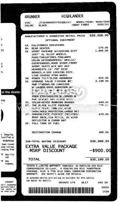

No, the "Sport Edition" didn't debut until '01. The Highlander was '99 and '00. There were no badges of any kind that identified a "Highlander" as such, just the designation on the window sticker.
Toyota 4Runner Highlander Information
sticker.jpg~original
