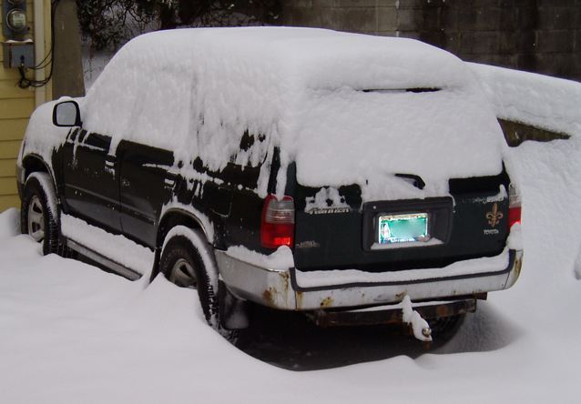

1) trailer hitch is rusted into the receiver. i managed to get the pin out, but the hitch is still rusted in place
2) rear license plate screws are rusted and stripped to hell. currently have the rear plate taped on.. bad idea i know
3) rear defroster/rear window/rear wiper/ center tail light all not working... too coincidental to be separate probs i thought, but not sure where to start diagnosing

i have sprayed the receiver/hitch wd-40 on it back over fall before the snow came, letting it soak in for a second, i then began to beat it with a hammer, but i soon i realized it would take a sledge (if anything) to get it free. i did however, purchase some lock de-icer that worked like a charm on the tailgate key hole. hopefully theres something out there that might work as well as that did... suggestions here??
i did check the fuses under the hood and the ones under the dash. well i should say i checked the ones i knew how to check, the smaller plastic ones not any of the big bulky fuses. either way, i couldnt find any that were out unfortunately, so im not sure what the deal is there.. the rear defrost DOES works on occasion, but doesnt generally stay on for very long if it is working at all.

For your rusted receiver:
Get some PB Blaster or similar spray for loosening rusted/frozen bolts.
Soak it from the front and in the holes and from the back. Let it sit overnight. Soak it when you get home. Soak it again before bedtime. Do this over and over again for 2-3 days. Then and not earlier, go at it with a sledge.
If you don't get some sign it is freeing up, you need to put some heat on it. I am not talking about a blow dryer (too low) or an acetylene torch (too hot) but something in between. Buy a propane torch (used by plumbers and available at any hardware store)
Start slow, applying heat all around. Gradually heat up the receiver. Not red hot, just hot. Take a wack or two. Heat it a while...take a few more..repeat the cylcle...etc.
Be careful not to get the torch near the bumper or painted body.
Patience, heat and force will get it loose. Always does for me.

for the rear hatch problems, check the wiring where it goes from the inside of the truck to the hatch. that pivot point will likely break the wires over time. same thing happened to mine (which coincidently is a '00 base model...and i live in vermont)
i was able to pick up the entire wiring harness for $15 from a guy who was parting out a dented hatch in the classified forum

Have you tried wrapping the screws with teflon tape (thin white plumbers tape) so they bite? This can be a temporary solution.
Hatch Wire Routing:
I recall the hatch wires go from the hatch through a grommet on the pillar and then into and down the left rear pillar. From there they go below and under the truck. If you unscrew the bottom/top trim, unscrew/remove the rear cover reciever and then gently pull the side pillar trim away (be gentle), you can access the wires. I don't recall seeing any connectors, it is a straight run.
I would check the actual wire connections on each item. Clean them up, check for good seat and then add some dielectric grease. Replace/check the bulb connection too.

for the receiver, just put a chain around a BIG tree and hook it to ball. slowly ad more and more pressure until it pulls out.
I have a practially brand new tow package off of a 2001 sr5. its been in FL the whole time and ..... was only put on not too long ago. lemme know if you're interested
If the head has been shredded, get a dremel tool and cut a X in it. If the head has sheared off, they make a screw/bolt removal tool. They go by several names. Here is one example: Screw Extractor Available at any decent hardware or automotive store. Drill the damn screws out.
After thinking about it, if the receiver will not come out, consider dropping the spare and beat it out from behind. You could also unbolt the hitch from the frame. Then you can stand it up and drive the receiver out from the back.
