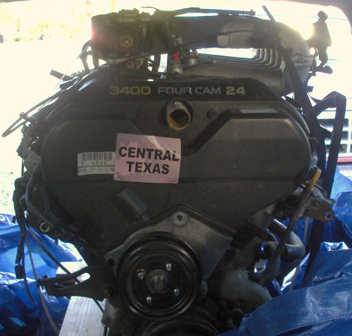

Hello All,
Just purchased a Black 99 SR5 4runner with a 3.4 V6 at an auto auction. Ran a Carfax report after puchase, no accidents and I seem to be second owner/ milage at 127,232. Right after purchase I put the SUV in shop to have broken timing gear and broken bolt removed from cam, well it seems like I will be needing to install a new engine. Mechanic stated "catastrophic engine failure." I'm debating about taking on the engine install myself and wondering how difficult this would be for a newbie. I can do basic car care,brakes,water pump and starter. I've already purchased a replacement engine from a wrecked 2002 4runner and was wondering if this should be a direct swap? My 4runner has the following 5VZFE SR5V ATM 4FC FA16 202 and 2002 has 5VZFE SR5V ATM 4FC FB17 8L7 . I've found a link at YotaTech http://www.ncttora.com/fsm/1996/SIL/fsm/repair.html but was hoping someone might have a few tips or tricks to make install easier for a newbie. Thanks and hope you guys don't flame me to bad.....Pic of new engine to be installed included, sorry about the size of pic but can't seem to shrink it to a smaller size.
Thanks Clint

i think the the newer engine is drive by wire and the 99 uses a throttle cable. So you might have to change intake manifolds and associated sensors.

The 3.4 from the 2002 has also has different vacuum tube setup than the other 3rd gens. And the drive by wire throttle. I would consider looking for a 99 3.4
By appearance both engines look identical and since replacement engine came with fuel injection unit installed, was hoping that would carry over as well. Guess my luck didn't hold out on that one. Think 2002 engine should still work "crossing my fingers" but now it will just take a little longer to install.
